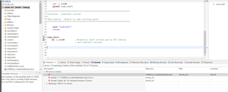

We are using F28M35H52 controller in our device, We are developing the firmware upgrade.
We have developed a separate bootloader (MCU side) for the same. When we jump from the bootloader we face the following issue:

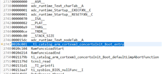

1) When we jump to "main" location of the application, the code doesn't execute further
2) When we jump using the c_int location (taken from the .map file), the code executes properly
3) Now, this c_int file varies with every build. This is making it difficult for us to execute the firmware upgrade functionality.
Can you please guide us on how we could jump to the main location or is there a method to fix the c_int to a specified location?
The jump to application start location works fine in the DSP code. The application start location for DSP is configured in the .cmd file
Similar method for MCU doesn't work.
