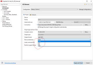

What is the difference between be32 and big option in Device Endianness in code composure studio?
  • I can't seem to find it documented, so with CCS 11.2 created a project for a TMS570LC4357 using compiler ti-cgt-arm_20.2.6.LTS and tried the different options for the Device Endianness field in the CCS General project properties.
    readelf -h was used to dump the header fields of the generated executables related to endianness. The results are:
    Device endianness readelf -h output
    be32
    Data:                              2's complement, big endian
    Flags:                             0x5000000, Version5 EABI
    be8 Data:                              2's complement, big endian
    Flags:                             0x5800000, Version5 EABI, BE8
    big Data:                              2's complement, big endian
    little Data:                              2's complement, little endian
    Therefore, the big option in the Device Endianness in CCS appears equivalent to BE8.
