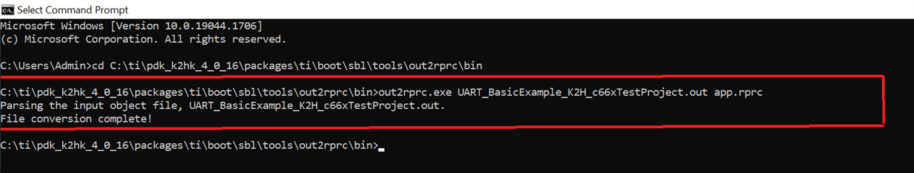

I want to make loadable image files of .out application to write on the EVMK2H board. as described in the link (https://software-dl.ti.com/processor-sdk-rtos/esd/docs/latest/rtos/index_Foundational_Components.html#k2h-k2e-k2l), I generated two files with these commands:
  1. out2rprc.exe [.out file] [rprc output]
  2. MulticoreImageGen.exe LE 55 [output name] 0 [rprc output]

    Plus what you have mentioned above, would you please help me to generate (.dat) and (.bin) files from the user application (.out) file? I searched and tried different ways to do that, but I didn't get the result. I only have (.out) file and need to generate (.dat) or (.bin) file to load to the memory browser into the address 0x80000000 and flash it via norwriter_evmk2X.out or spi_flash_writer.out with memory address 80000 that was written in the config file.
    The only way that I got results was only for example based on the (KeystoneII_Boot_Examples_UserGuide.pdf - page 7):

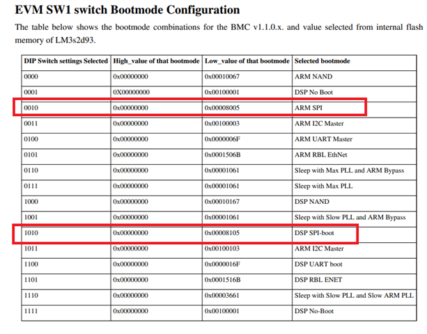

    1. connect to the evmk2h board via ccs v9.3 (board is on the NO BOOT mode (0001))
    2. connect to the arm core0 and initial the core with xtcievmk2x_arm.gel
    3. connect to the DSP core0 and load norwriter_evmk2X.out
    4. load the spiImage.dat  file into the memory address 0x80000000 via the memory browser window
    5. resume the running to flash
    6. power off the board, changing the dip switch to the SPI NOR mode (0010)
    7. finally, I see the result that we expect to see on the UART console (Tera Term) like this: (Mentioned in the PDF)

    1. Set your EVM to NO BOOT. Power on, launch target configuration in CCS, and connect to Core 0. Be sure the GEL file is used and DDR is initialized.
    2. Copy the UART-app binary you want to flash to "C:\ti\pdk_c665x_2_0_16\packages\ti\boot\writer\nor\evmc6657l\bin" directory.
    3. Rename the binary you copied in the previous step to “app.bin”.
    4. In CCS, select Core 0 and open the Memory Browser
    5. In the Memory Browser window, right click and select “Load Memory”
    6. Load your app.bin to 0x80000000. Do so by selecting app.bin for the file, click Next, and input 0x80000000 for Start Address (Type-size selected should be 32-bit)
    7. Load C:\ti\pdk_c665x_2_0_16\packages\ti\boot\writer\nor\evmc6657l\bin\norwriter_evm6657l.out
    8. Run Core 0. This will program the flash memory.
    If it succeeds, the console will print “NOR programming completed successfully”

    Answer : According to the DIP switch settings for
      1)    - ARM - SPI
      2)    - DSP- SPI
    You can differentiate.

    1.1 the SPI example of package "Keystone II Boot Examples" is working on the ARM cores or DSP cores? with DIP SW 0010 is worked, but with DIP SW 1010 it doesn't work and print nothing on the UART.
     2. DIP SW 0010 means the bootloader is ARM and code is running on the DSP cores? or meaning the bootloader is ARM and code is running on the ARM cores?

    Answer : It is neither of them. The address 0x80000000 is the MSMC RAM. This MSMC RAM memory  is common for both ARM and DSP core
    First, the code is loaded into MSMC RAM and then using the nor_writer program, it is copied from the MSMC RAM into the NOR flash memory.
    QUESTION 2:
    With DIP SW 0010 -- This is for ARM SPI. IF we load the uart code ( built for ARM arhitecture ) it will run on ARM core of K2H.
    The same UART example is exisiting to build for DSP architecture.  We can build for DSP and make it run on the DSP core of K2H. The DIP SW for DSP-SPI is 1010

    This is what I did. Follow the steps slowly and sequentially. Maintain the same file names as I used... for a quick result....
    Step1:
    1. Using CCS, build the UART_BasicExample_K2H_c66xTestProject and create a  ".OUT" ---->  "UART_BasicExample_K2H_c66xTestProject.out"
    Step2:
    1. copy the .out file, UART_BasicExample_K2H_c66xTestProject.out, from the path -- C:\ti\pdk_k2hk_4_0_16\packages\MyExampleProjects_DSP\UART_BasicExample_K2H_c66xTestProject\Debug  into the path ----------------C:\ti\pdk_k2hk_4_0_16\packages\ti\boot\sbl\tools\out2rprc\bin
    Step 3:
    1. open command prompt
    2. Go to path -- C:\ti\pdk_k2hk_4_0_16\packages\ti\boot\sbl\tools\out2rprc\bin
           C:\Users\Admin>cd C:\ti\pdk_k2hk_4_0_16\packages\ti\boot\sbl\tools\out2rprc\bin
    3. In command line execute the out2rprc to convert the .out into the rprc format
          C:\ti\pdk_k2hk_4_0_16\packages\ti\boot\sbl\tools\out2rprc\bin>out2rprc.exe UART_BasicExample_K2H_c66xTestProject.out app.rprc
    4. Copy the app.rprc from path --- C:\ti\pdk_k2hk_4_0_16\packages\ti\boot\sbl\tools\out2rprc\bin --- into the path C:\ti\pdk_k2hk_4_0_16\packages\ti\boot\sbl\tools\multicoreImageGen\bin

    12. Power off and put the DIP switch settings to SW1 -- 0010 -- ARM-SPI
          ----> MLO -- SBL will run on ARM, initialization will happen
          ----> It jumps to the uart app and runs on DSP.
