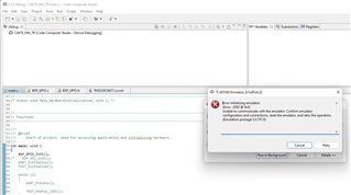

If I try to load my code and run it, I get this error:
Error initializing emulator:
(Error -2083 @ 0x0)
Unable to communicate with the emulator. Confirm emulator configuration and connections, reset the emulator, and retry the operation.

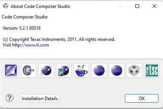

(Emulation package 5.0.747.0)
If you can give me the configuration settings and if I am using the correct version of CCS (which is 5 according to the documentation), then, I would be fine.  Right now, I cannot even connect to the board and don't know where to start to find out how.

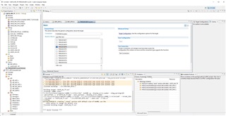

Currently, when I configure the settings in the Target COnfiguration Editor (which, as stated above, is also where I test the connection using the TEST CONNECTION button), I have the connection set to: TI XDS560 Eumulator and on board or device I have that set to TMS320C6878.  One anomaly I have noticed is that there were NOT a TMS320C6678.ccxml command file, so I modified the, "/C6678_HW_TP/TMS320C6657.ccxml" command file and specified the TMS320C6678.

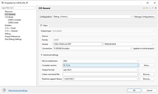

On the properties window, I have the following items programmed:
Variant: C66xx Multicore DSP and TMS320C6678.
Connection: TI XDS560 Emulator
Endianess: litle
Compiler Version TI v7.3.4
Output Format: eabi (ELF)
