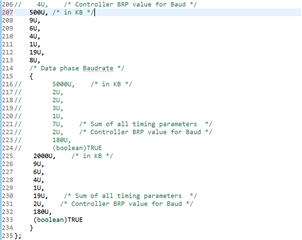

Nominal bit rate:0.5Mbps, data bit rate: 2Mbps. Configuration in MCAL:
 92 /* Baud Rate Structure for all configsets */
 93 CAN_CONFIG_DATA_SECTION_NON_CONST static Can_BaudConfigType
 94     CanConfigSet_CanController_0_CanControllerBaudrateConfig_0 =
 95 {
 96     500U,      /* in Kbps */
 97     8U,       /* Prop Segement value */
 98     6U,          /* Phase Segment 1 */
 99     5U,          /* Phase Segment 2 */
100     1U, /* Sync jump width */
101     19U,  /* Sum of all timing parameters  */
102     8U,   /* Controller BRP value for Baud */
103          /* Data phase Baudrate */
104     {
105         2000U,     /* in Kbps */
106         8U,        /* Prop Segement value */
107         6U,           /* Phase Segment 1 */
108         5U,           /* Phase Segment 2 */
109         1U,  /* Sync jump width */
110         19U,  /* Sum of all timing parameters  */
111         2U,   /* Controller BRP value for Baud */
112         180U, /* Specifies the Transceiver Delay Compensation Offset in ns */
113         (boolean)TRUE, /* Specifies if the bit rate switching shall be used */
114     }
115 };
But there are still errors in receiving frames. Is there still some problems with the baud rate calculation?
