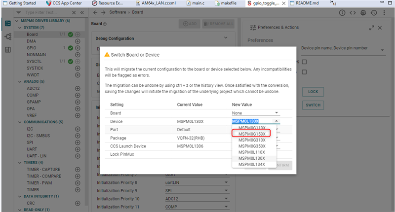

Tanaka-san,
Which version of CCS are you using? With CCS 12.4 and SysConfig 1.16, I see options for 150x:
Also, note that we have a new CCS product called CCS Theia. It is based off VS Code and is the recommended environment for MSPM0:
