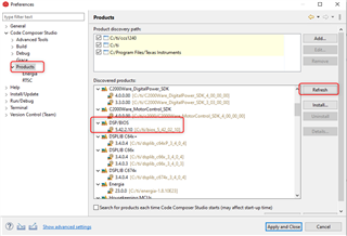

    Check the discovered products list to see if your desired DSP/BIOS version appears:
    If it is not there, try pressing the Refresh button. Note that you may also need to add the path to it in the "Product discovery path" if you installed in some custom location.

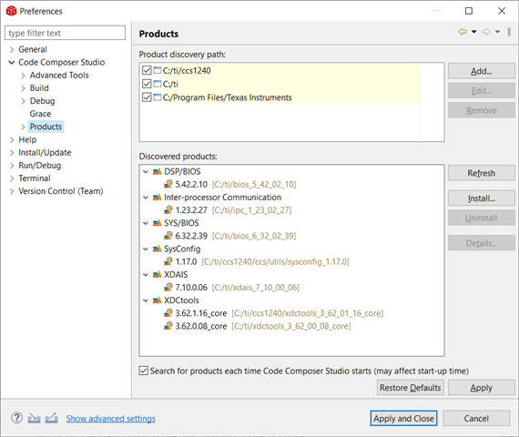

  • Through the Window->Preferences option, I was able to get CCS to finally discover the installed products. I had installed them separately but when CCS launched, it hadn't indicated it found them. When I show the same pic, I see this:
    To eliminate any issues my my code, I created a blank DSP/BIOS project based on the TSK template. When I attempt to build it I see the error:
