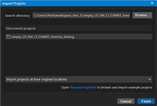

My customer has a requirement to put the CCS project files(.project, .cproject, .ccsproject) into a folder starting with a dot, for example, .demo_project. But in CCS20.1.0, the project will not display if a project folder starts with a dot.
I tried following steps to reproduce this issue:
1. Import a project from any SDK, for example, empty_LP_EM_CC2340R5_freertos_ticlang from simplelink_lowpower_f3_sdk_8_40_02_01. The project shows correctly in CCS:
2. Add a dot to the beginning of the project folder name, the project will disappear from CCS:
3. In CCS, import the project to its original location again. After this step, the project is sill not showed in CCS:
4. However, at this moment this project can be built with Project -> Build All menu, which demonstrates the project actually exists.
