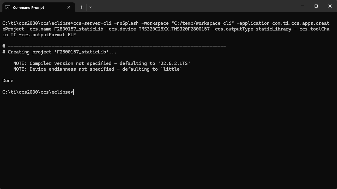

  • In addition to the projectspec files provided by JohnS, you can also use the project CLI commands to create a library project from scratch:
    https://software-dl.ti.com/ccs/esd/documents/users_guide_ccs/ccs_project-command-line-createProject-options.html
    Example of a static library project for F2800157 configured for using the TI compiler and the file type for ELF:
    > ccs-server-cli -noSplash -workspace "C:/temp/workspace_cli" -application com.ti.ccs.apps.createProject -ccs.name F2800157_staticLib -ccs.device TMS320C28XX.TMS320F2800157 -ccs.outputType staticLibrary - ccs.toolChain TI -ccs.outputFormat ELF

     I'll try the CLI method provided by   now.
  • Thank you  ,
    This method is exactly what I was looking for. Simple and easy to customize and get to work.
