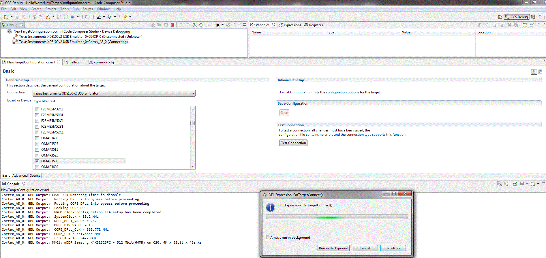

    I did a View->debug and I was able to select theEmulator_0/Cortex_A8_0.  The default is C64XP_0 fo rsome reason.  I did a "Connect Target" and the "GEL Expression: OnTargetConnect()" has been running for 10 minutes now and still running.  I think the behavior is just like you mentioned in ealier post.

  • I added more GEL_TextOut() and I saw the OnTargetConnect() was hung in mDDR_Samsung_K4X51323PC();
    My first guess is the OMAP3530 evm use a different DDR than the AM3517 EVM.  I will check the schematic.
    Which GEL file do you have specified in your target configuration? If you are using the default omap3530_cortexA.gel included with CCS that will likely not work, and that could very well be the reason for it hanging when processing GEL functions. GEL files are highly dependent on the board and are tailored to match the hardware, so are typically provided by the board manufacturer. If you are using the LogicPD evm you need to download the GEL file from their web site. Please download and use their GEL file for the AM3517 and let us know if that helps.
