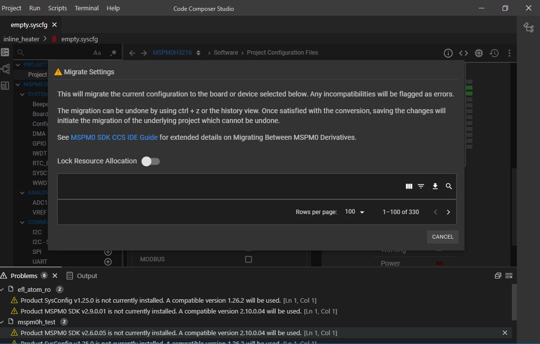

I am unable to change the package/ pin count in CCS while creating a new project.
I have uninstalled and reinstalled CCS but it didn't help.
please look into it
images attached for reference.

It looks like the same issue reported here: SYSCONFIG: SysConfig Window Issues: Users can not modify the migration window size and can no edit it some laptop screen
I can reproduce the issue with 1.26.2.
However, when I use 1.27, there is are two options available: "Migrate To A Specific Device" and "Help Me Choose My Device". The latter has the same problem. But the former seems to work.

This is a known issue that will be fixed in SysConfig 1.28 (which will be bundled with CCS 21.0 by default):
