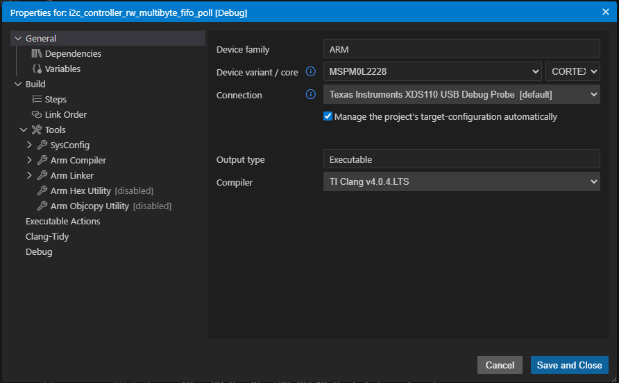

How to enable .ASM or .lst file output?
For the TI Clang compiler, use the -save-temps options to keep the generated assembly file.
