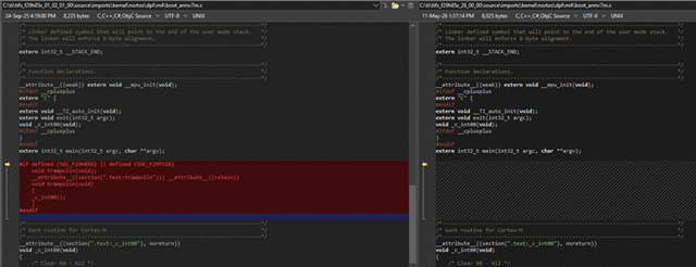

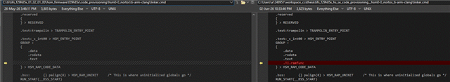

  • Hi Marek,
    Yes, that is an SR10 sample, you are correct.
    Could you try/confirm a couple of things:
    1. After switching to UART Boot Mode, connecting to COM Port and giving a PORSn/XRSn, do you see a hex dump in the serial console? This is to check that the UART connection works fine.
    2. After switching to Flash Boot Mode, are you able to connect to the Debugger in CCS using this CCXML file?
    Thanks and Regards,
    Aditya Singal
  • Hello Aditya,
    1. UART works:
    Texas Instruments., Inc.10617ff0000000000000001004632394838355800000000000400cdab0000010001000000000000000000000000000000000000000000000000000000ea0a5e7e2acbf7b587821766454242f87a23ca45cc1ad0d595661468eb571558b019a4cd88ac5c2e901ce8ca171c2dceed66273e8796c839597402eff5c32ccf0000000000000000000000000000000000000000000000000000000000000000000000000000000000000000000000000000000000000000000000000000000046272137e1f59f6995483b785162949c1c4f18d43715360b0e05bedcea1714296f29c113d271ebedd39b7d29919ac13f0b6dda2e
    2. JTAG in CCS and UniFlash also works.
    Unfortunately, I am still unable to perform provisioning using Cybershield Toolkit - just as described in the first post
  • Hi Marek,
    Issue regarding Key Provisioning was resolved offline. This post is to publicly share the resolution: The issue was that the device had a program already flashed that contained a certificate with crypto-Unlock extension (default in F29x SDK examples). This extension disables the HSM and thus the call to loadhsmRT was not passing. The resolution was to erase the flash to remove the cert with this extension.

    For code provisioning:
    The secure binaries provided with the CyberShield Toolkit will only work out-of-box with our latest Silicon Revision (Rev B) devices.
    This is documented as a limitation in the CST README also.
    The latest HSM firmware from TIFSv26.00 can be backported to run on the older silicon (Rev A) with a few linker modifications.
    The path to the binaries can be changed to match the path of the custom binaries for Code Provisioning after modifications.
    The reason for these modifications is that the location of the Vector Table was moved and the HSM Entry Point was also changed in the HSM ROM.
    To backport the code so that it works on RevA silicon:
    •  Add trampoline section to boot_armv7m.c file of RAM and Flash based HSMRT.
    • For Flash based HSMRt, use the same linker as TIFS v1.2.1.
    • For RAM based CP HSMRt, use same linker as TIFS v1.2.1 but add .TI.ramfunc in the GROUP section of linker file.
