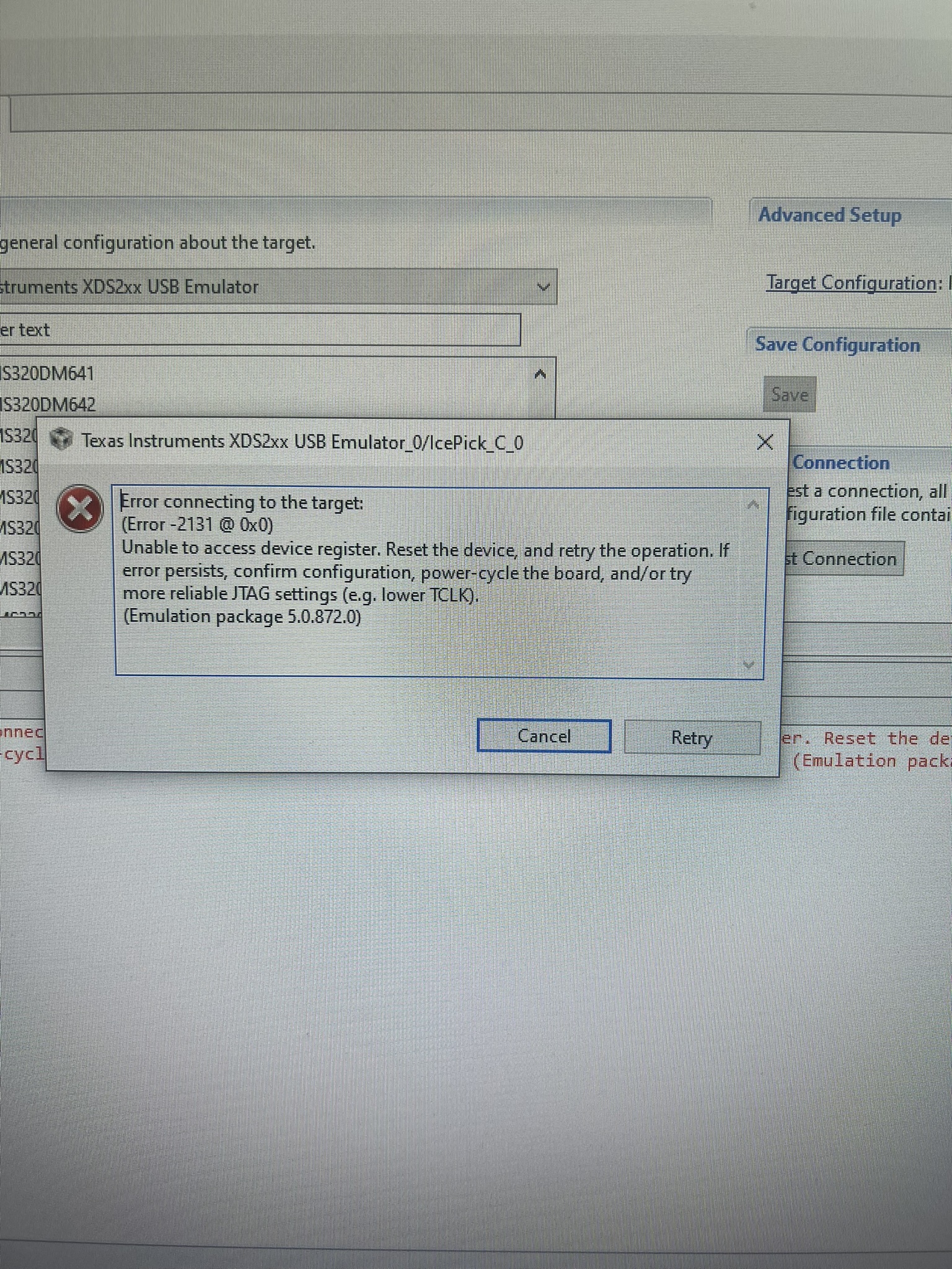

Hi I'm having somet trouble and would appreciate any help.
Recieved XDS200 brand new friday to replace an older XDS510. Followed small quick start guide included, the desktop weuse is on CCStudio V5.3 which should be compatiable. Checked in device manager and the drivers look to have automatically assigned correctly. Created a new target confid selectring the right connection and device. Try to begin debug and get error -2131.IMG_9388.JPEG
When I attempt to do the test congifuration this the output: [Start].txt
[Start]
Execute the command:
%ccs_base%/common/uscif/dbgjtag -f %boarddatafile% -r -o -S pathlength -S integrity

  • Hi Jay-J,
    Thanks for the details — the scan-path test output tells us exactly what's going on. The stuck-at-ones/stuck-at-zeros pattern in the JTAG IR and DR integrity tests means the emulator (XDS200) can't reliably shift data through the scan path on the target. This is almost always a physical/electrical connection issue, not a software or driver problem — error -2131 is CCS reporting that it can't establish a valid JTAG connection because of this.
    A few things to check, in order of likelihood:
    1. JTAG connector/adapter mismatch The DM6446 EVM typically uses a 14-pin JTAG header, while the XDS200 ships with a 20-pin TI JTAG connector. If you're using a 14-to-20 pin adapter cable, double-check:

  • Hi thanks for the reply.
    1. I have an adaptor and have confirmed pin orientation.
    2, I allowed time for board to become fully powered
    3. These were already set this way
    4. No issue with pins
    5. This looks to have provided some success more below
    6. I could try this, do note XDS510 has been used on this PCB to confirm that it is operational.
    7. I will look into this, the PC we have is not on the network for security reasons.
    As to point 5. I have done some adjusting to the clock speed and repeatedly testing the config. 2.2MHz -2.6MHz seems to consistently allow JTAG DR to consistently pass, I cannot seem to find a speed that gives close to pass results for the IR Integrity test.

  • Hi Jay-J,
    Good progress — the DR path is now clean, which confirms the physical connection and power are solid. The IR failure is the remaining blocker, and the pattern you're seeing is a very specific clue.
    What the IR failure pattern tells us:
    Looking at the corrupted data:
    • Scanned out:
      0xFE03E0E2
    • Scanned in:
      0xFC07C1C5
    This is a bit-shift by 1 — every bit has shifted one position. This is a classic symptom of an IR length mismatch in the scan chain definition. The JTAG IR path-length test reported 2 bits, but the DM6446 actually has a longer IR register. The emulator is miscounting the IR length, causing it to shift data by the wrong amount.

  • Hi, Just an update
    1. I cannot find a setting to change the length in my config, does code composer not auto assign this?
    2. Yes I have ensured the settings are correct.
    3. I have updated both the TMDSEMU200-U firmware and the emulation package. This does look to have got us slightly closer see below.
    After some more testing today I can get to around 9% corruption around 2.0-24MHz. - Just noticed from the results below the test is now setting the path length to 3 bits which may be the reason behind the improved pass rate. If there is a way to adjust this I think it could be the final part needed.
