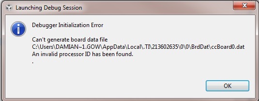

Damian,
Try steps 2 and 3 of this troubleshooting section: http://processors.wiki.ti.com/index.php/Troubleshooting_CCS#Debugger
If that does not help, you may need to delete and recreate your target configuration (.ccxml) file. Let us know how it goes.
