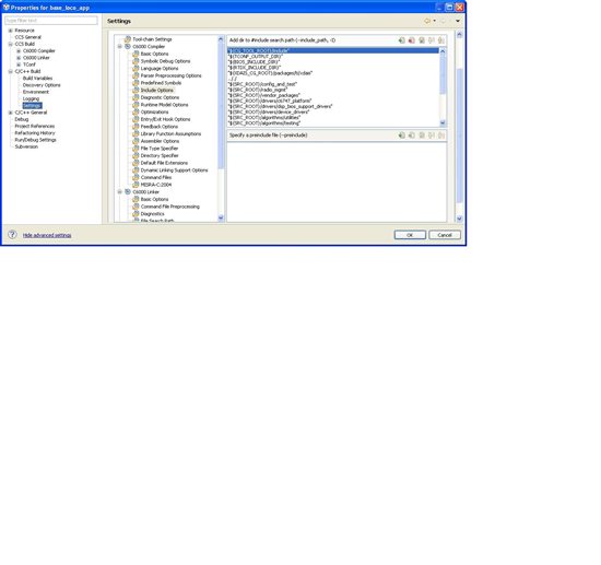

We use SVN for managing source code changes and are now in the process of integrating this into CCSv5.1.  We can download the subclipse plugin and notice it doesn't seem to work with linked files.  Our CCS projects contain mostly linked files (e.g. files residing outside the project folder).  This files aren't recognized by the plugin. The screenshot below illustrates the problem.  Files that are in the project folder show SVN info and can be compared to base versions in the repository.  files linked into the project won't do this.  Is this a bug?  Is there a workaround?  Thanks - Mike

    Try adding your paths and variables in the generic eclipse version of these options.  Many of these will be found under Project->Properties but you will need to show the advanced settings and go to C/C++ build.  Do you know if linked resources have the same problem in a generic eclipse project, non CCS?

    I think my paths are already setup using the generic.  Can you look at the screenshot and tell?  Or give me an example of how I set this up?

    have a look at these two posting I found on google.  It seems this is normal subeclipse behaviour, however there are a couple work arounds it appears including svn:externals
    http://svn.haxx.se/subusers/archive-2006-05/0014.shtml
    http://svn.haxx.se/subdev/archive-2005-06/0119.shtml

  • Hi Lisa,
    I looked into these posts.  Couple things.
    1. It seems like this issue is common in any eclipse project containing linked resources, not just CCS eclipse.
    2. The solution is really to restructure your whole project so there is no linked resources.  In the repository, you can keep all your source files in whatever folder structure you like.  Then when you do a check-out, you direct SVN to take the files that are in a project and throw them all into one working folder that will be the eclipse project folder.  Then there are no linked resources;  everything to build your project is in one folder.  When changes are made and committed back to the repository, they are made back in the original repository location.  So it kind of flattens the folder structure into one.  We don't prefer this solution as it means we need to basically create a project from scratch and do some research how to script all this (for every eclipse project!).  It also means our working copy isn't a "mirror image" of the repository anymore.  This now becomes a bigger decision on if we want to change the way we structure/manage our dev projects.
    I think for now we'll just do all our SVN management outside Eclipse (as we were doing before upgrading to CCS5.1) and perhaps transition to what subclipse suggests at a later date.
