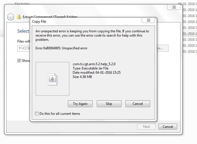

I am trying to install the latest version of CCS5 using the Offline Installer from this page:
http://processors.wiki.ti.com/index.php/Download_CCS
Which links to this page:
http://software-dl.ti.com/dsps/forms/self_cert_export.html?prod_no=CCS5.2.1.00018_win32.zip&ref_url=http://software-dl.ti.com/dsps/dsps_public_sw/sdo_ccstudio/CCSv5/CCS_5_2_1/
However, during the install I get a ton of errors as seen below:
I am installing this on a fresh Win7 machine, am I doing something wrong? Do I need to install an older version first and then update to this?
    have you tried redownloading in case of corruption? Do you unzip the installer first?  Do you have antivirus disabled?  Do you use only directories with no accented or special characters or spaces?  Any details would help.  Also if you would send us the contents of your installjammer registry directory.  (Found under program files or program files(x86))
    Lisa
  • I had tried two download attempts, but it seems the third time a charms.
    Cheers!
    glad the tips helped!  All the best with development.
    Lisa

    01/07/2016 07:18:50(GMT) - checkStatus - CCS_ERROR: Installer failed to install jre correctly. The 2 most common reasons for failure are:
    	1.  Anti-virus on your computer could have impeded the executable.
    	2.  Download is corrupted.
    Please submit these logs to TI for analysis using the next dialog.
    You may also visit the TI E2E CCS Support forum for additional help.
    The install logs are located in: c:/ti/ccsv6/install_logs.

    01/07/2016 07:18:50(GMT) - checkStatus - CCS_ERROR: Code Composer Studio v6 installation failed.

    0844.file corrupted of TI.docx
    It looks like your downloaded offline installer zip file is being corrupted somehow. It could be your anti-virus real time file checking which is doing this. Please try turning off the AV and real time file scanning and try again.
    Danish
  • Hi Danish,
    Thanks a lot. It has been installed now.
    we downloaded the files after making AV off.
    Mahesh
