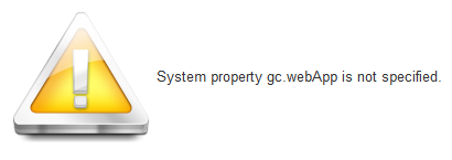

  • Hi MartinS,
    I am pretty much trying to do the same thing as Donald, namely creating a simple GUI for the blinking LED program (in order to be able to create a GUI for our bigger project eventually). However, even with previous tips I'm still not able to create a working executable file... I copied everything in the right directory, and tried copying the CCXML file from the example provided when downloading CUI composer runtime. Also disabling the line
    session.options.setBoolean("UseLegacyStopMode", true);
    didn't work. I keep getting this error:
    What could possibly be the cause of this? And how can I fix it?
    Pieter

  • Hi Pieter,
    Unfortunately, I missed your original question. We suggest that new threads be started rather than old threads re-used even though information might be relevant.
    Getting back to your question:
    In you webapp you should have a launcher.exe that gets created when you export. That executable is a shell that invokes ..\..\eclipse\GuiComposer.exe -Dgc.webApp="LauncherdirectoryName". relative paths are used thus you need to place your app in appropriate place in directory structure of GUI Composer Runtime and you need to use launcher.exe. Another way would be to use GUIComposer.exe and pass in argument. LauncherDirectoryName needs to be the directory name for your app. e.g. GC Runtime includes one example app called "modem_m3",  thus the command line would be GUIComposer.exe -Dgc.webApp="modem_m3". This parameter allows multiple apps to be available in the same runtime.
    Martin
  • Sorry, the actual command line would need to be
    GuiComposer.exe --launcher.appendVmargs -Dgc.webApp="modem_m3"
    Martin
