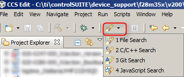

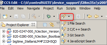

Also I need some help in an advanced searchin CCS. I'm not able to search for a text in the whole project. Sometimes it works, but not in all cases. For instance look for something which is not part of the code... I know that I have to be careful which project is active (sometimes it is not quite clearly shown in the project tree!). I have tried out several search methods [Str+H] but neither is really reliable. Is it because of the linked ressources? But with [F3] I have no problems. I still use Codewright for editing my code since it has some nice features which I really miss in the eclipse environment.

    Did you try "File Search" or "C/C++ Search"? If the text you are searching for is inside header files that are not "linked" to the project but are referenced via compiler include paths, then I believe File Search would not find those occurances. It would only search in files that are visible in the Project Explorer view. But the C/C++ Search should find it.

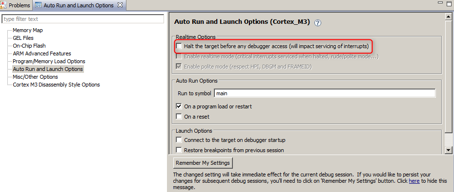

  • To clarify on the setting to enable breakpoints when code is running, the screenshot shows where the option is available:

    Setting breakpoints is working now, thank your for linking the threads. Still have the problem not seeing static variables if they are not in the context of the active module. Is there a refresh?
    The search I will try out to find out how it works eventually. Right now I'm fine with editing my code in CodeWright and using CCS just for compiling/debugging.
