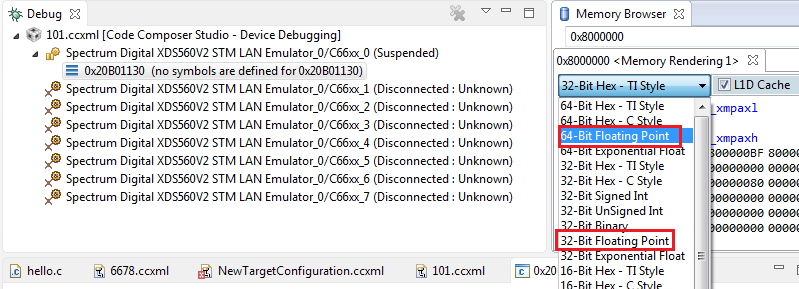

hi,
i'm using ccs 5.4 , my chip c6678.
i have lot of floating point data. while debuffing i want to see the float values in memory browser.
ccs 5.4 doesnot show it, no options are there in the drop down list.
i have worked with some previous version it had the option
hi,
Version: 5.3.0.00090. has the option to view 32 bit float
it even have 64 bit float.
i'm using 6678
Thanks, I see it also (available in 5.3.0 and missing in 5.4.0). I filed a bug for this. Tracking ID: SDSCM00047876

hi,
I have seen that the floating point option is not present in the 5.5 version of ccs also.
its very important for my work.
need a urgent patch..
The fix will be available in CCSv6.
It already is in the CCSv6 beta 3 build which is available now if you want to try that. Alos, Beta 4 is coming out this week if you want to wait for that.
