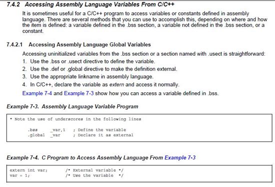

Actually when I added:
.global My_var1 in asm file and
Extern unsigned int My_var1; in c file
ð I have this error [E0000] parse error
There other ways?
Hello!
You can refer to chapter "Interfacing C and C++ With Assembly Language" of UG 4137.ARM_spnu151i.pdf (chapter 6.5) or 3364.TI_TMS320C28x Optimizing C_spru514f.pdf (chapter 7.4) .
Igor
The error "[E0000] parse error" means you have made a mistake in the syntax of the file. Please show us the exact text of the error message, as well as the exact text of the line it indicates contains the error. Please cut-and-paste it; do not re-type it in the forum.
