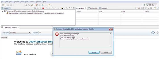

TMS320F2812 is not connecting through the parallel port
Other Parts Discussed in Thread: TMS320F2812
The project requires TI CCS v5.3(5.3.0.00090) and TMS320F2812 target.
When I tried to connect to the target using parallel port(Printer port) cable, it isnt working and gave the following erro(in picture below). Is this a known issue? If yes please let me know the way forward.
Complete Feature set of CCSv5.3 is installed(which comes with the bundle)
OS used : Win 7
    Did you try running the Spectrum Digital diagnostic tests in the SDConfigEx utility?

  • Hello Ki,
    The problem looks like its with the Windows 7. When the same PC has Winxp + CCS5.3, it connects to target. But when it has Win7 + CCS5.3 it doesnt. Also, when a printer is connected to that pc, the parallel port is working.
    Do you have any solution for this?
    The OS version is Win7 Professional SP1.
    Thanks and Regards,
    Bala
  • Parallel port emulation should still work with Windows 7. What happens when you run the diagnostic tests from the SDConfigEx utility?
