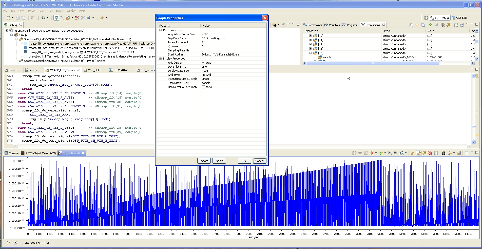

We are trying to graph a 16384 points of signed ints and the graph looks more like (but not quite) and ABS value of what we expect.  We also tried graphing the data when it got converted to a Floating point complex number and still got a graph that did NOT even come close to resembling the data.
I could supply the pictures but dont have access to the system this morning.

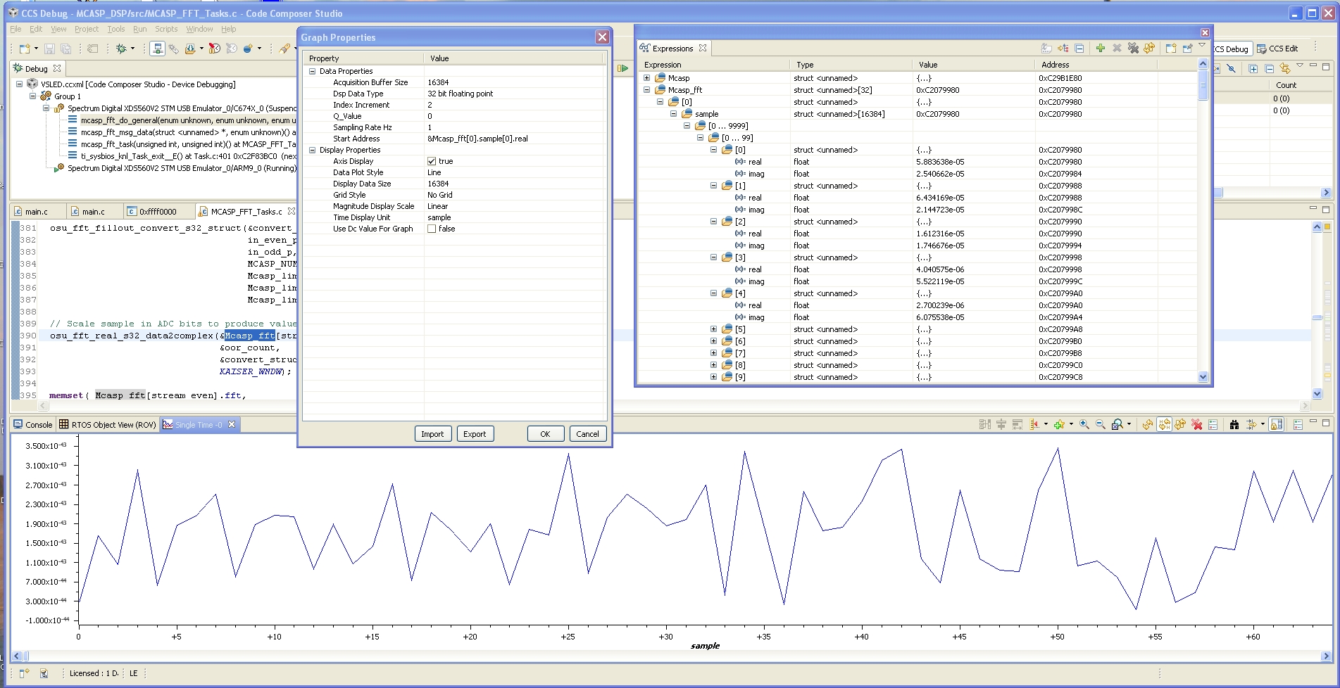

  • First picture is of a 16384 X 32bit Float.  Notice the graph has a scaling of 10^(-43) where the data is all 10^(-5).

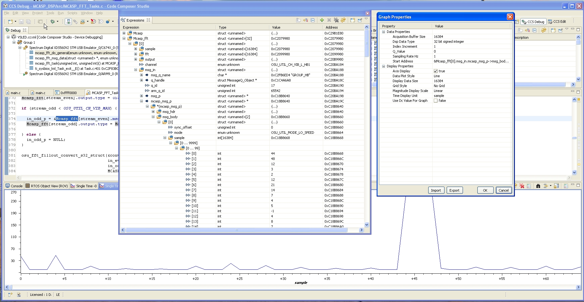

    Here is the same wave but in signed 32 bit format:
    This is simple as it gets.  The numbrs in memory dont match the graph at all.  No software needed, just dump the memory.

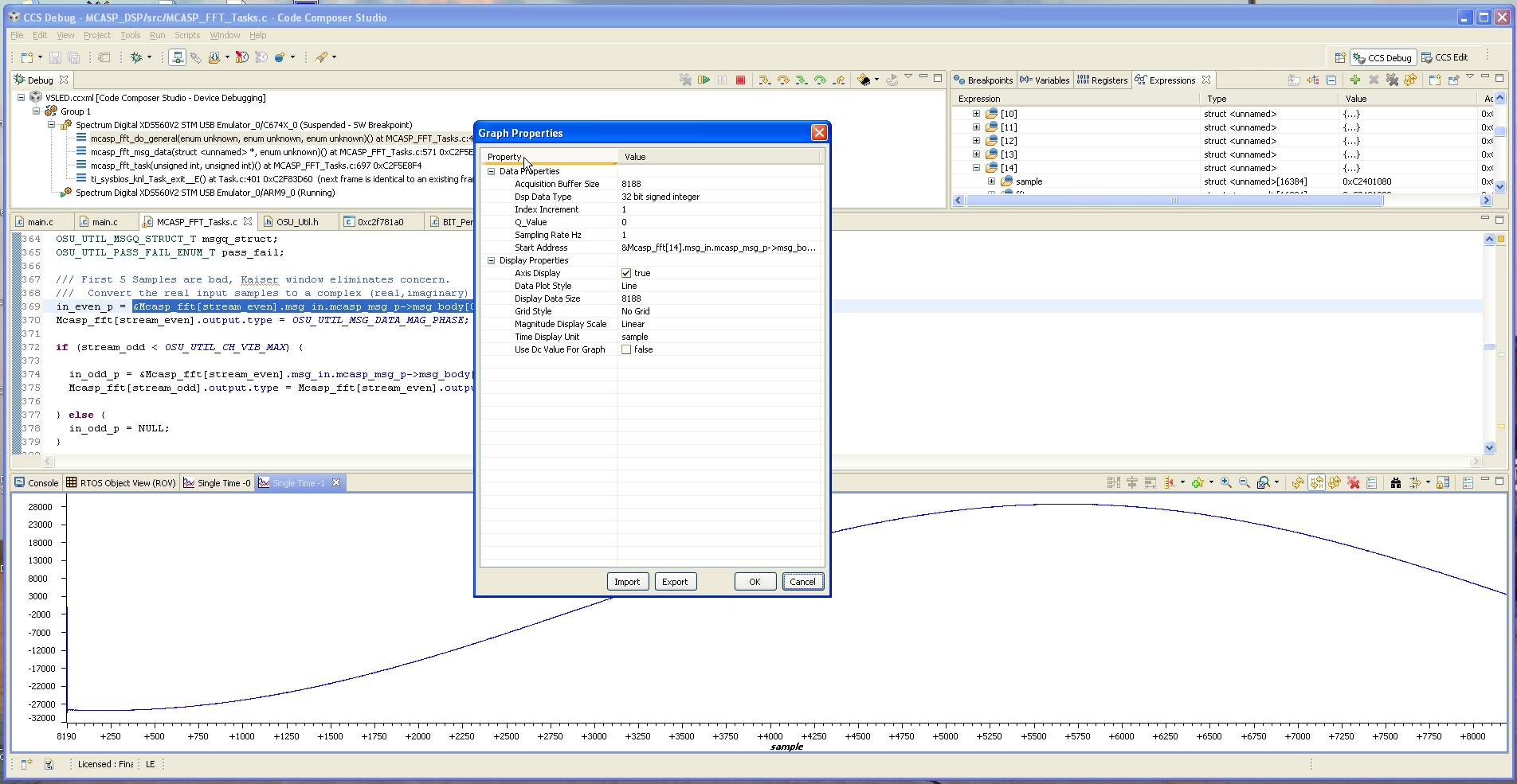

  • Here is the capture at 4094 (32 bit floating point real side of a complex number):

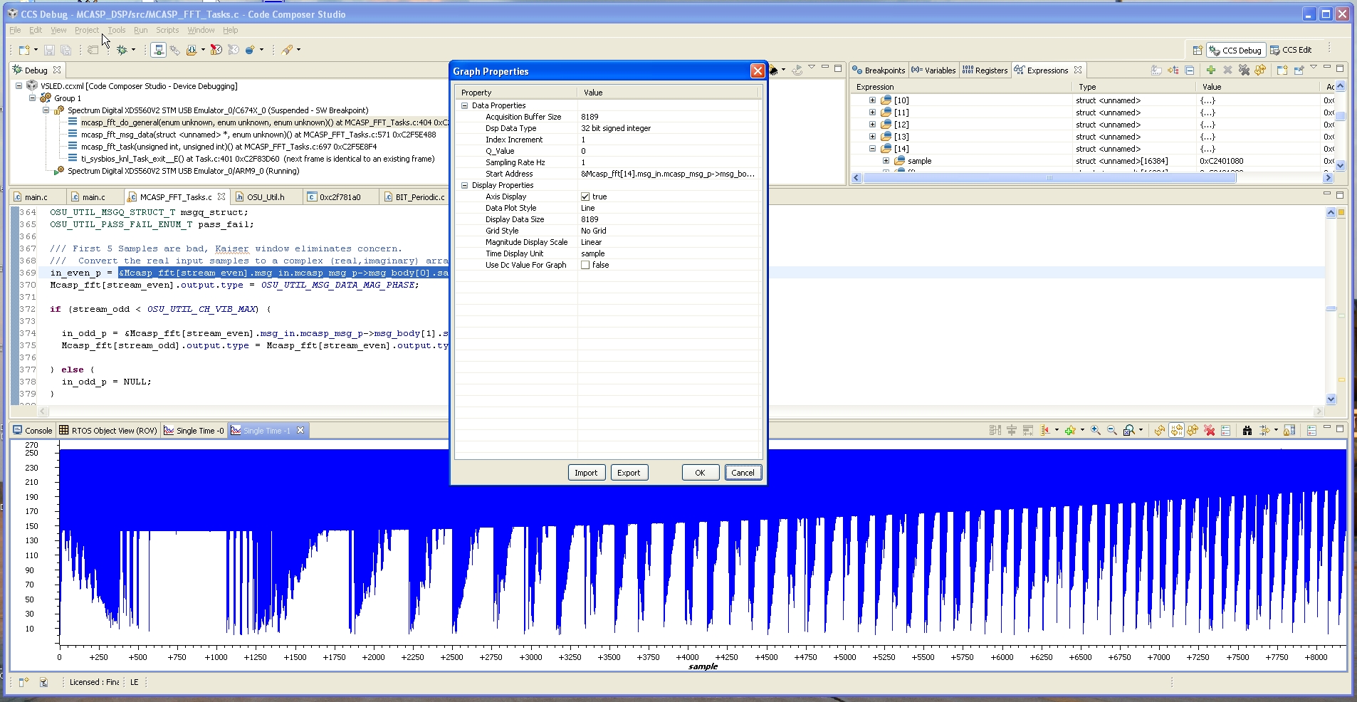

    Same data but with 4095:
    I did confirm that if I look at the non-complex data (32 bit signed) I can see 8188 and at 8189 it becomes garbadge...

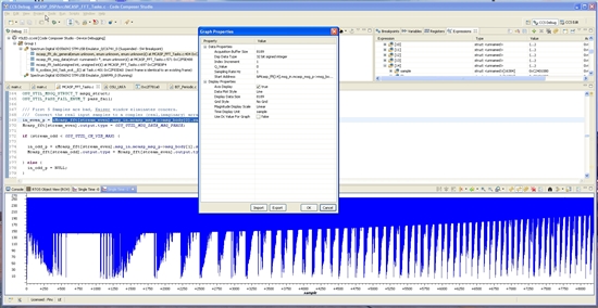

  • Here is what we get for a wave using Excel and just simple dumping the memory:
    Thanks for sending your findings; they confirm that 8188 is the magic number for a limit of some internal sample counter of the graph display (4094 x 2 = 8188), and therefore this impacts the proper display. I can also confirm that CCSv5.3 nicely displays 16384 32-bit floating-point samples, which is expected (I did not test the limit, but I am sure it is high).
    In this case this is a bug introduced with the newer releases (and not a simple "you hit the limit of the tool"). I will check with the developers and file a bug. I will have to see it is possible to release a patch, but unfortunately I can't make any guarantees.
