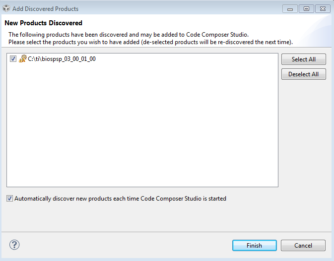

I installed BIOS PSP for SYS-BIOS (BIOS PSP 03.00.01.00). Now, everytime I start CCS the following prompt comes up.
This prompt keep coming everytime CCS start. Looks like, new product discovery scheme doesn't work. The problem is happening to my collegue.
Please help,

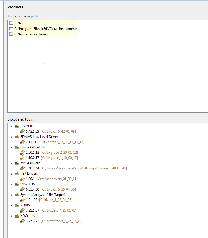

    Therefore I wonder if the product was correctly added. Can you verify this under menu Window --> Preferences --> Code Composer Studio --> RTSC --> Products? You should see something like this:
    You could potentially try to remove the package and see if it gets properly installed a second time.

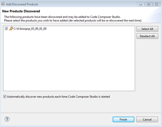

  • Hi Rafael,
    Following is the screen shot.
    I have tried to remove the package and installed again. Same error.
