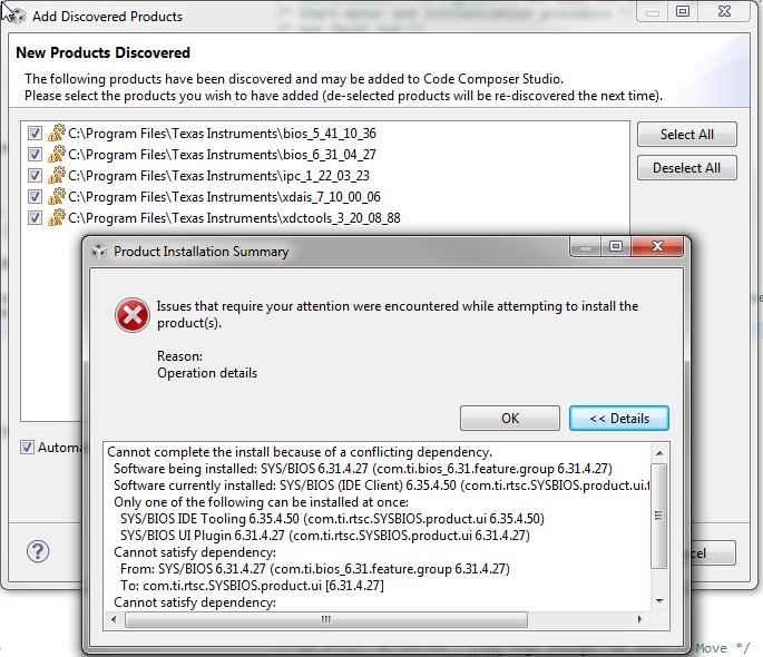

when launching CCS5.5, the tool found 5 new products:
- bios_5_41_10_36
- bios_6_31_04_27
- ipc_1_22_03_23
- xdais_7_10_00_06
- xdctools_3_20_08_88
I have two problems:
- I don't exactly undersand the functionality of these tools
- I can't install them due to a problem of conflicting dependency
Please, could you help me to know what I have to do with this?
Thanks in advance
Steve

  • Hi Lisa,
    thanks for your answer...
    My actual project doesn't use the BIOS. But I prefer to install all modules correctly for future projects...
    I attached once again the picture:
    I hope you can see it...
    Steve
  • Hi Steve,
    I would ignore this.  For some reason the update is not liking an older version being found.  You have a newer version installed already.   Also note if you have other versions from other/older ccs installations, you can much more easily add them under Window->Preferences->Code composer studio->RTSC-> products
    Lisa
  • Hello Lisa,
    OK, thanks for your answer. I have other CCS versions installed on the PC. As I have the newer versions installed, I will ingnore this message...
    Steve
