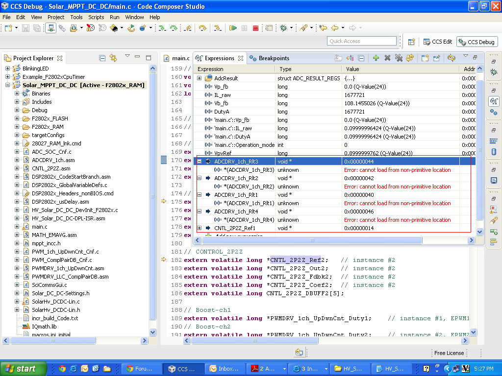

Hi Darain,
The example you mentioned in this message , with main and "*main" is happening with my code. "error cannot load from non-primitive location", Could you please let me know the resolution for this problem?
Actually ,have gone through all the forum conversations and have tried the stack size change approach, as well as other approaches stated. But not able to solve the problem.
Hi Tanmayee,
In the screenshot, you are getting errors when you try to deference a variable of type void*. If you know it's actual type, you can cast it in the expressions view and then expand it to see it's members. For instance:
(MyStructType*)ADCDRV_1ch_Rlt3
Darian

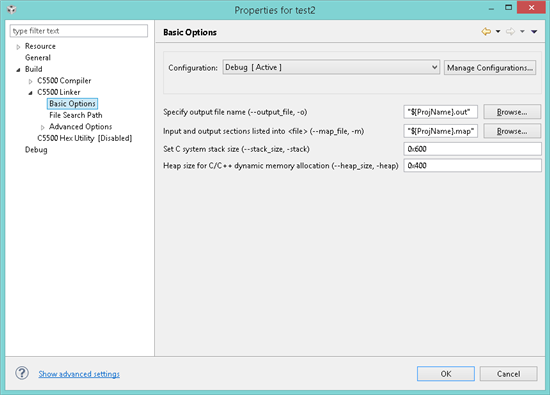

Thanks Richard. Your reply should be selected as the right answer too. I got into the exact problem and your post helped me out.
I created a new project and by default the heap size was default to 0x0 and the stack size was default to 0x512. I oversaw the project settings and didn't spot this out until I saw your post.
Notes to TI: I think the CCS project template should really need to be changed to give the heap size something more sensible than 0x0 (can't do anything with zero heap size). It was a pain to figure out why Tera Term didn't work for me while all the code looked perfectly fine.

Girish and Mehwish,
If you post a picture of your expressions view when you get this error, I may be able to explain it to you. Most likely the variable is a void* and you are trying to deference it. You would have to cast the variable to see it.

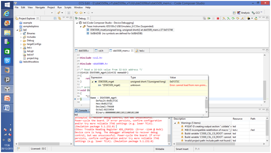

Mehwish,
It's very hard to read the text on that picture, but it looks like you are hovering over a function. Functions have a value (where they are located in memory), but cannot be dereferenced, even though their type is a pointer type. Dereferencing them would be equivalent to calling them. This is as expected.
Are you seeing this error in a case where you expect the expression to evaluate to a value?
