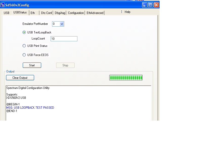

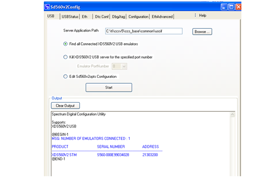

  • hi,
    there is only one USB tracepod connected, and USB status ok when we test via Sd560v2Config.exe.
    one point is that the CCS5.4 GUI operation to catch trace, it works. so I think the tracepod script automation issue is the JAVA API calling exceptions. need you confirm.  also attached GUI operation output.4276.ccs5-4.rar

  • David, please change the USB port in TraceCntrl_DefaultSettings_PRO_Globals.xml from 1 to 0 as shown below.
    <ADDR_CURRENT_USB>0</ADDR_CURRENT_USB>
  • David, please ignore the prior post.  We found the root cause of the issue in both the example and the autotrace.java script.  The problem is that the NewTargetConfiguration.ccxml file being used is for a different type of receiver.  Please replace NewTargetConfiguration.ccxml with a file created in CCS for the "Spectrum Digital XDSPRO USB Emulator" Connection type (shown below in green).   Since you have already created a target configuration file in CCS that works with this receiver you may choose to use that existing file.  To determine the path where the target configuration file is stored on your PC, pelase hover the mouse pointer over the tab name in the Target Configuration pane (shown below in red).
  • Hi Jason,
    Actually for autotrace script ccxml configuration file, which is already copied from CCS GUI ccxml file. this configuration file works when catch trace by CCS GUI. see below picture.
    Compared further more, you are asking to create configuration with Spectrum Digital XDSPRO USB Emulator, I will recreate this type configuration and try.
    With new Spectrum Digital XDSPRO USB Emulator configuration,
    1. CCS GUI to catch trace is ok whatever in Spectrum Digital XDSPRO USB Emulator or Spectrum Digital XDS560 V2 USB Emulator connection.
    2. Automation script can run and can get trace.bin and mytrace.tdf files after execution. But trace data is incorrect. We use CCS GUI to analyze such bin/tdf first, (Automation script analysis is not working yet as API change, code commented).
    See below pic and logs.
