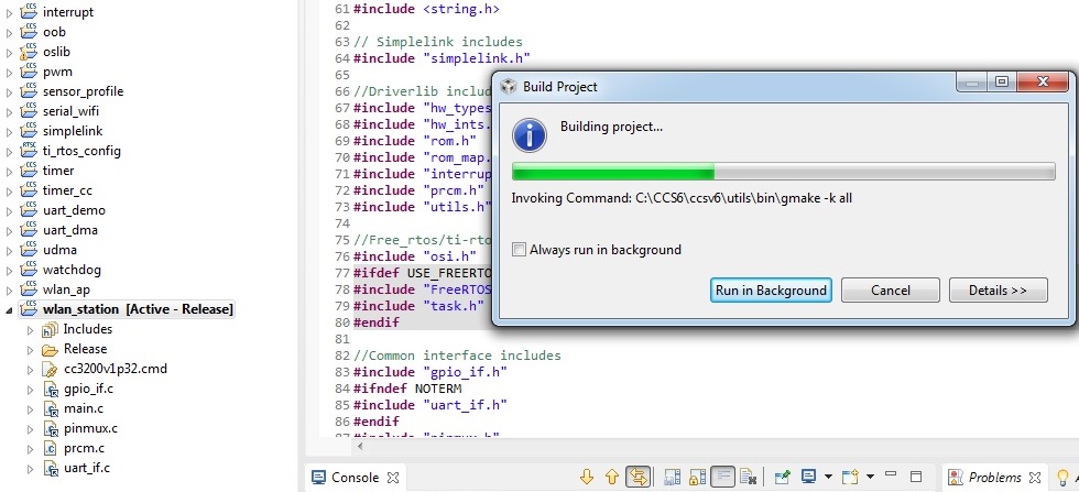

After adding files to project building takes forever
Other Parts Discussed in Thread: CC3200, CC3200SDK
    I am using CCSV6 and studying wlan_station for CC3200 Launchpad. I "add files'  prmc.c and selecting copy files as option. I build the project and the build takes forever.
    Now, I cancel the build process and nothing happens and the CCS seems to hang.
    What should be the right procedure so the CCSV6 won't build forever and not hang after I cancel build process?

  • Hi Gautam,
         The link you shared does not work. "404 Not Found"
         The CCS still hangs after cancelling. I will just close CCS through task manager. I hope I can still open CCS afterwards. Here is my CCS screenshot below.
    - kel
       After I remove the prcm.c at wlan_station, the build also takes forever.
    - kel

  • @AartiG,
        I removed the wlan_station and import it again. Now, I am able to build the wlan_station again.
        These below are my actions when the wlan_station builds forever.
    1. Added prmc.c to wlan_station and selected "link to files" as option.
    2. Build project and there was an error "Cannot open source file  . . ."
    3. Removed prmc.c from wlan_station.
    4. Added prmc.c to wlan_station and selected "Copy files" as option.
    5. Build project and the build takes forever.
        I just did the above steps again and the build takes forever again. I will remove wlan_station in workspace and import it again.
    - kel

    I can reproduce the hang by following this exact sequence of steps. The specific sequence that triggers it is first "linking" the source file, then deleting it, and then "adding" it again. I have submitted bug # SDSCM00050668 for this issue.
    The build does not hang if the file is either "linked" or "added" just once. Of course, the first time buid will generate the: cannot open source file "inc/hw_types.h" error as mentioned by John, which you can resolve by adding the include search path. Once that path is added it should build fine.

  • OK, I can no longer reproduce it with v6.0.1. Sorry I should have tested with that version before filing a bug.
    Kel, could you please give 6.0.1 a try and report back if you can still reproduce the hang?
