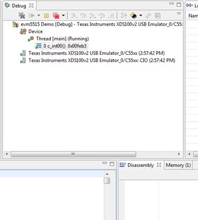

I am inheriting a project that uses a TI C55 DSP with a CCSv4 development environment.  The computer in our lab (which I don't plan to use for primary development or debugging) is able to successfully compile and run the debugger.  A partial screenshot is here:

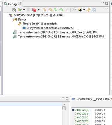

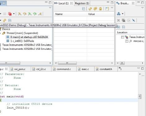

However, when I loaded CCS in my laptop and imported the project, the debugger cannot find the main program, and therefore does not run, as shown below.  I am expecting the debugger to find the main() thread in startup.c, which is partially shown, but it does not.  There's probably something fundamental that I am missing or needs to be changed in my compile/debug options, but can't seem to find it.
I am getting a <symbol is not available> message.

    One of the most common details that prevent the code from reaching main() is hardware initialization - either from a GEL file or from the code itself. Given the code is the same, I suspect the presence/absence of a GEL file may be getting in the way of a successful run.
    Several threads like this one discuss this and similar scenarios. You can search for "code does not reach main -msp430" and see if other ideas may come (the last -MSP430 is due to an issue with the compiler tools that is not applicable to C55x)

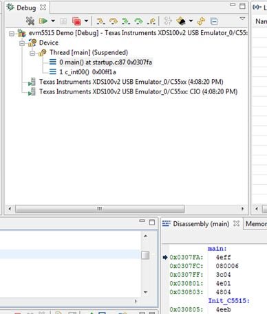

    However, after a week of inactivity, I ran into a similar problem in which the debugger sometimes runs and sometimes does not make it to main().  It comes up with one of the screens shown below.  When it doesn't run, the .gel file is not getting run as the "PLL 100 MHz" and other print statements do not get displayed.

    Some screenshots of what comes up when the debugger runs and the debugger does not run.
    Good:
    Bad1:
    Bad2:
