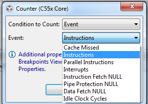

    gmarsh said:
    Secondly, I'm trying to find a cycle count somewhere in the GUI, which would let me single-step through my assembly functions and look for stalls - no luck finding such a thing. Any suggestions?
    All the supported events by the counter is shown in the drop-down list when enabling a counter in the breakpoints view. I don't see anything particular for stalls unfortunately.
