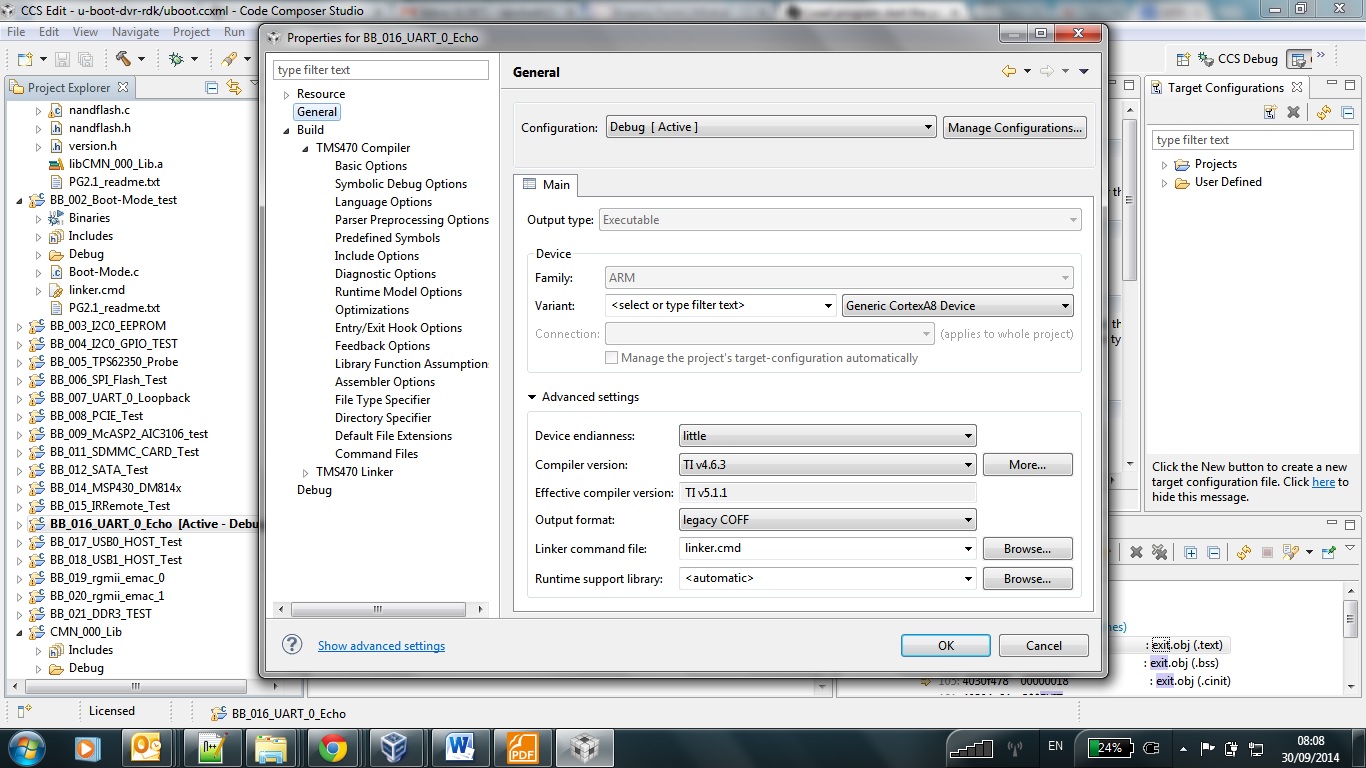

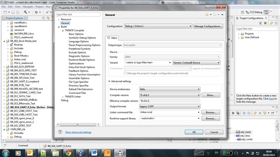

  • Ran S. said:
    I did not change the original project settings (it is still TI 4.6.4).
    Actually, you are using 5.1.1 to build. I can see it in your screenshot.
    "compiler version" is the compiler version originally used when the project was created (4.6.3)
    "effective compiler version" is the compiler version that will be used in your environment (5.1.1).
    This happens because CCS doesn't detect 4.6.3 so it will use the version it does detect (5.1.1).

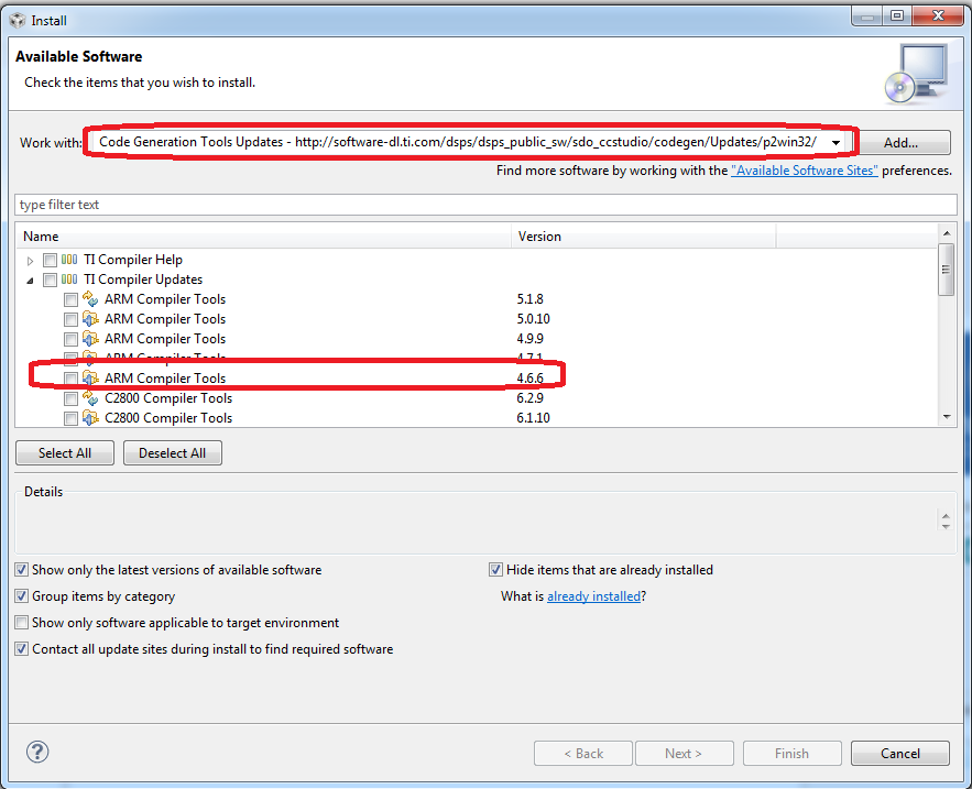

    If you don't have 4.6.x compiler, you can get it from the Update Manager. Go to 'Help -> Install New Software' and select the compiler updates from the drop down list and choose a 4.6.x compiler:
