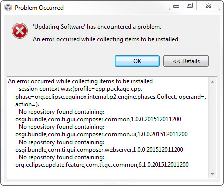

CCSV6 GUI update fails can't find repository
An error occurred while collecting items to be installed
session context was:(profile=epp.package.cpp, phase=org.eclipse.equinox.internal.p2.engine.phases.Collect, operand=, action=).
No repository found containing: osgi.bundle,com.ti.gui.composer.common,1.0.0.201406261800
No repository found containing: osgi.bundle,com.ti.gui.composer.common.ui,1.0.0.201406261800
No repository found containing: osgi.bundle,com.ti.gui.composer.webserver,1.0.0.201406261800
No repository found containing: org.eclipse.update.feature,com.ti.gc.common,6.0.0.201406261800

  • I'm getting a similar error:
    No repository found containing: org.eclipse.update.feature,com.ti.dsflash.win32,6.0.0.759
    No repository found containing: binary,com.ti.dsflash.win32_root,6.0.0.759
    In my case the update that's failing to install appears to be DebugServer Flash version 6.0.0.759. The three other updates I was offered appear to have installed successfully, and no longer appear on the available updates list.
    This is on a fresh CCS6.0.1.00040 install on Windows 8.1. I ran the "offline installer" package using an administrator account, to D:\Programs\CCS6.0.1.00040\.

    !MESSAGE No repository found containing: binary,com.ti.dsflash.win32_root,6.0.0.759
    !SESSION 2014-10-18 12:28:23.911 -----------------------------------------------
    eclipse.buildId=4.3.0.M20130911-1000
    java.version=1.6.0_13
    java.vendor=Sun Microsystems Inc.
    BootLoader constants: OS=win32, ARCH=x86, WS=win32, NL=en_GB
    Framework arguments:  -product com.ti.ccstudio.branding.product
    Command-line arguments:  -os win32 -ws win32 -arch x86 -product com.ti.ccstudio.branding.product
    !ENTRY org.eclipse.equinox.p2.engine 4 4 2014-10-18 12:31:25.671
    !MESSAGE An error occurred while collecting items to be installed
    !SUBENTRY 1 org.eclipse.equinox.p2.engine 4 0 2014-10-18 12:31:25.671
    !MESSAGE session context was:(profile=epp.package.cpp, phase=org.eclipse.equinox.internal.p2.engine.phases.Collect, operand=, action=).
    !SUBENTRY 1 org.eclipse.equinox.p2.artifact.repository 4 0 2014-10-18 12:31:25.671
    !MESSAGE No repository found containing: org.eclipse.update.feature,com.ti.dsflash.win32,6.0.0.759
    !SESSION 2014-10-18 12:42:36.786 -----------------------------------------------
    !ENTRY org.eclipse.equinox.p2.engine 4 4 2014-10-18 12:43:21.036
    !SUBENTRY 1 org.eclipse.equinox.p2.engine 4 0 2014-10-18 12:43:21.036
    !SUBENTRY 1 org.eclipse.equinox.p2.artifact.repository 4 0 2014-10-18 12:43:21.036

  • Hi Frank, Robert,
    We had some hiccups with our download servers a few days ago. They should be resolved by now. Do you still see the same errors when running the updates now?
    ki
  • Tried the updats again.  Found 3 two worked but the GUI one still fails
  • After 6 months still having the hiccup??
    !ENTRY org.eclipse.equinox.p2.transport.ecf 2 0 2015-04-02 13:50:40.904
    !MESSAGE Connection to software-dl.ti.com/.../p2.index failed on software-dl.ti.com. Retry attempt 0 started
    !STACK 0
    java.net.UnknownHostException: software-dl.ti.com
    !ENTRY org.eclipse.equinox.p2.transport.ecf 4 1006 2015-04-02 13:50:41.213
    !MESSAGE Unknown Host: software-dl.ti.com/.../content.xml
    !STACK 0
    !ENTRY org.eclipse.equinox.p2.transport.ecf 2 0 2015-04-02 13:50:41.250
    !STACK 0
    !ENTRY org.eclipse.equinox.p2.transport.ecf 4 1006 2015-04-02 13:50:41.561
    !STACK 0
    I still cannot download from the repos! Some solution over here??
    Looks like you may have some cache issues. Please do the following:
    Exit out of Code Composer Studio.
    Delete the <installdir>/ccsv6/eclipse/p2/org.eclipse.equinox.p2.core/cache and <installdir>/ccsv6/eclipse/p2/org.eclipse.equinox.p2.repository folders.
    Try your updates again.
    Please let me know if you're still having problems.
    Danish
  • Hi Danish,
    I got this problem only when I made CCS update the 'GUI Composer Feature'. I did what you proposed above, but that didn't solve the problem. Instead, I got the following :
    Could you please help me with this? I am newbie...
    Thanks!
    William
  • Hi William,
    # 5 on this wiki page provides a workaround for this issue.
    processors.wiki.ti.com/.../Troubleshooting_CCSv6
    Danish
