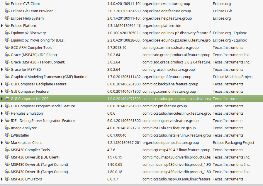

Hi, Platform Linux MINT 17.1
Memory 8GB on Laptop Sony Vaio SVS1511C5E
Processor I7 Quad Core
CCS Studio 6.0.1.00040
GUI Composer version (latest 6.0.0)

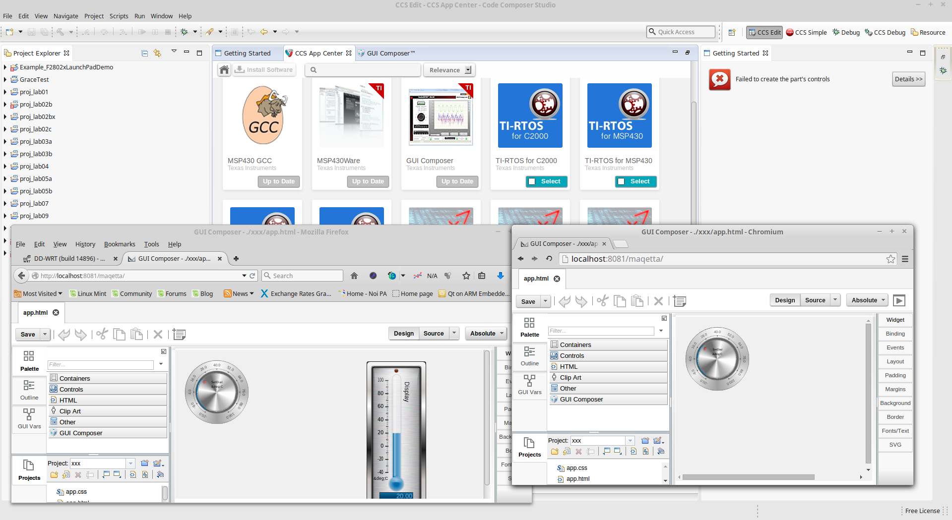

Was not working for a long time, long attempt to cure chromium where unsuccessful then I found instruction on internal browser setting to change use mozilla, this changed some situation,
Repaired things:
GUI opened, edit load save are working fine
APP Center started working fine so I updated all I see and reinstalled Grace too
Grace work fine now and generate code and compile.
C2000 compiler work fine and load code debugger work.
Broken things:
Getting started now crash but not CCS and it can be closed
GUI composer open regular, sometimes reopen and reload last appllication, hit of import project button crash CCS shutting down immediately.

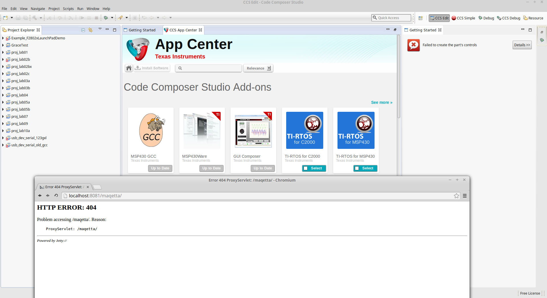

Hi Patrick, yes I confirm setting on ccstudio.ini where chrome, maqetta or maquetta no difference, both report 404 page not found and added 'u' after first attempt, if can be of help I can do more inspection and capture traffic, dump tcp or whatever can help identify/solve this issue at his root.
From NOW on ccstudio.ini last line chaged to:
-DTIBrowserType=mozilla
on loading ccstudio appear this way and both chromium and mozille where superimposed over.

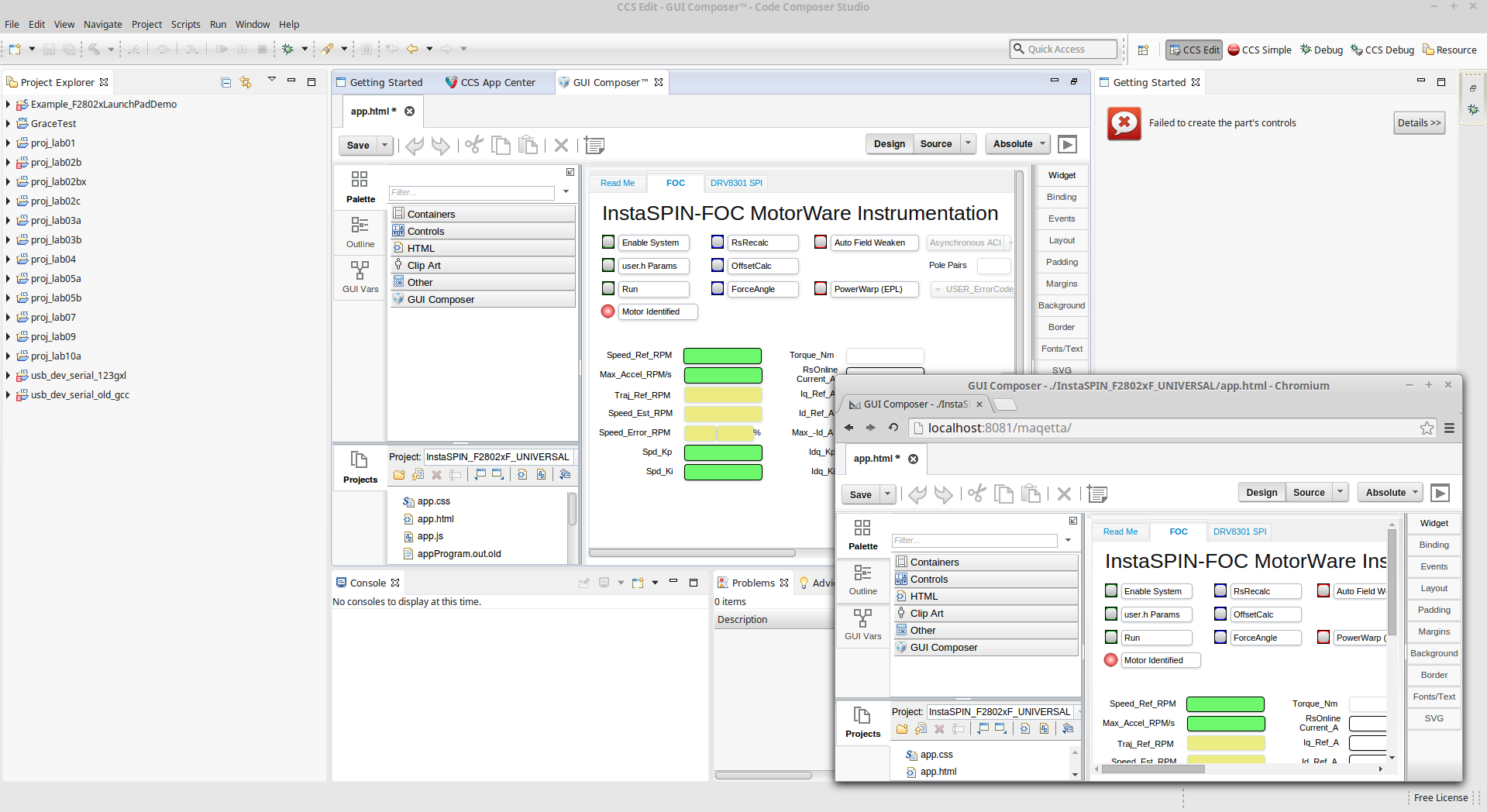

Both browser display GuiComposer, Chromium I again changed to 64 bit version, Chromium only display knob, on right temperature gauge was present but not visible.
Application now is also on internal CCS windows same look as mozilla.

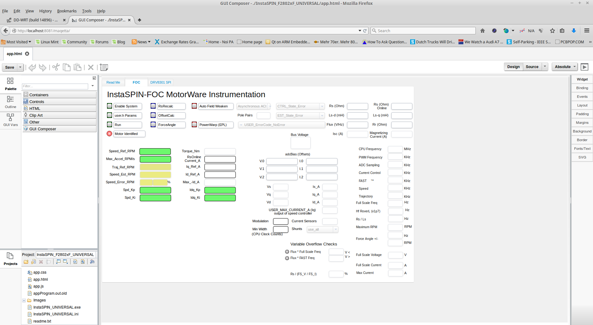

On external browser:
Mozilla I can import GUIComposer and it work, it right imported motorFOC pane.

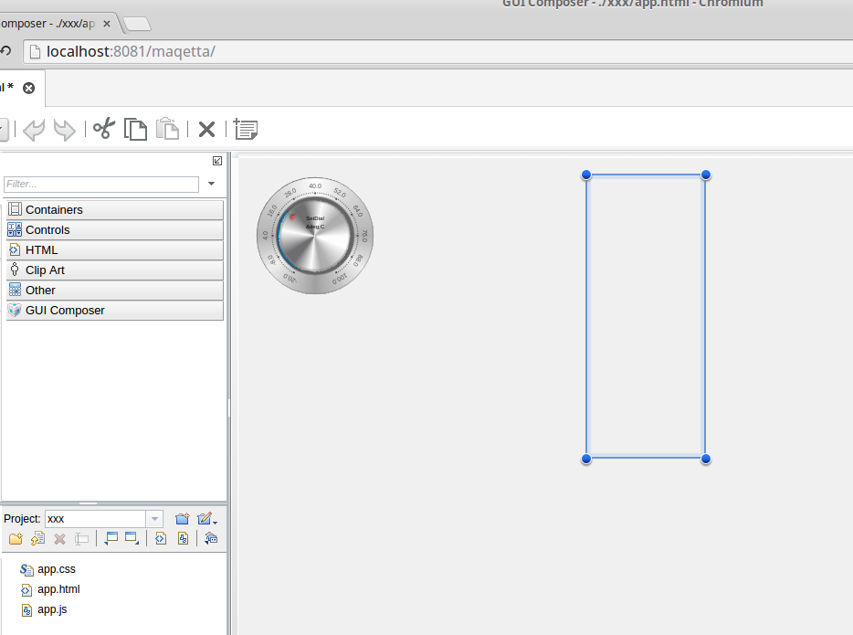

Chromium, two times wasn't working, I discovered pane asking for upgrade, loading and everything pops up is not in front of chromium but need hide main windows, after retry and doing just one time import selecting file and answering yes to library update and all it imported on chromium too. Import motorFOC too was on chromium now (64 bit version).

This is opening CCS without GComposer then after opening also chrome work:

This is Chromium where I selected gauge, it is present but not displayed, I think Chromium appear as more bugged than mozilla contrary to what I read from forum, maybe embedded browser suffer different problem.
