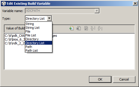

Ralf,
Ralf Goebel said:in CCS v5 it was possible to use variables containing semicolons within Pre-/Post-build steps.
Could you elaborate a bit more on what you mean? Do you mean that XDCPATH in this example has semicolons in its path?
I don't think there should be a difference in behavior between CCSv5 and CCSv6. In CCSv6, it is now easier to specify multiple post-build commands in multiple lines (which was not there in CCSv5) but other than that, they should be interpreted the same way. Can you provide more details on what your variable is set to and what error is reported by CCS?

I see how the variable with several paths separated by semi-colon is handled differently in CCSv5.5 and CCSv6.
In CCSv6, if you need to specify multiple paths or strings for a variable, try selecting one of the list options (String List, Directory List, Path List etc). I believe that should be handled properly. Let us know if that helps with your situation.
Sorry I misunderstood. I thought you were explicitly setting the XDCPATH. If you are using the dynamically generated variable, then yes, that suggestion will not work.
Can you provide an example of how the XDCPATH is being used in the batch file?
AartiG said:Can you provide an example of how the XDCPATH is being used in the batch file?
This is not necessary.
As you said, it appears that CCSv6 is treating the semicolons separating the paths as an indicator of multiple commands. I will file a bug report for this and update the thread with the bug tracking number.
