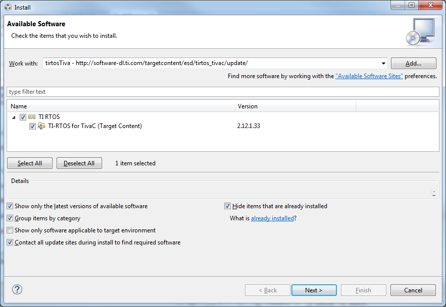

  • Hi Robert,
    Would you be able to try a different path to install TI-RTOS? You would need to start CCS and go to Help->Install New Software. When a dialog pops up, click on "Add" button in top right corner. In the dialog for Name enter "TI-RTOS for Tivac", the name does not really matter, but something relevant helps. Then in Location: field enter http://software-dl.ti.com/targetcontent/esd/tirtos_tivac/update/ Once you close the dialog you should see dialog like below. Check TI RTOS and click Next few times. The app center goes through a very similar process, but there is a very small layer on top of those manual step. Knowing whether it works with these manual steps would greatly to narrow down the problem area.
    Thank you,
    Martin
  • The TI-RTOS downloaded and installed correctly.
