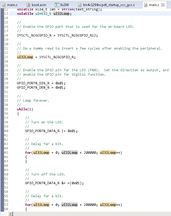

  • It looks the the standard Eclipse functionality in the CCS 6.1 editor can help with highlighting.
    If the select a variable or function the editor highlights the matching symbols. E.g. I selected the declaration of the ui32Loop local variable and references to it were highlighted - with different colors depending if the variable was read or written:
    Also, if the File Search is used lines which match show an arrow in the left column:
