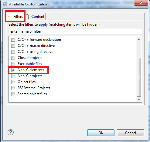

  • Roy - it looks like somehow those files/folders were specified to be excluded from the project and the view filter for the Project Explorer had the below option enabled:
    That would include filtering out all excluded folders/files from the view.
    The question is how did this happen if you didn't explicitly do this? Are you using some Eclipse plug-in (like VectorCAST) that might have mucked around with your settings automatically?

  • I don't know, Ki, it's a mystery.  I haven't used that dialog to set up any filters, and Non-C elements isn't checked
