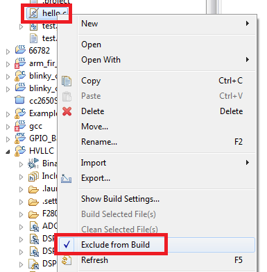

I needed to exclude some files in CCS ver 5 (Version 5.5.0.00077) and then I tried to "Un-exclude " and couldn't find the way to do it.
I saw a thread that dealt with this issu, 3 years ago, but I couldn't reproduce the way he handled it.
When I excluded the file from the build, I cannot see it anymore, and when I tried to add it again using the"add files.." function,
I got an error message that the file couldn't be coppied.
What is the correct way to "un-exclude " the files ?

To include it back to the build, right-click on the excluded file and select the option again:
Ilan Bogen said:When I excluded the file from the build, I cannot see it anymore, and when I tried to add it again using the"add files.." function,
When you exclude a file, it does not disappear by default, but is simply greyed out and with a "/" through it. If the file completely disappears from view, you might have a filter enabled that is hiding it. See the below link for more details:

Hi Ki,
I fixed it.
