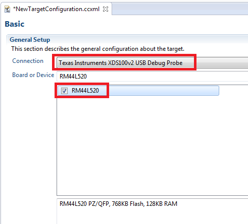

Hi ki,
The enclosure is my CCS6.1 setup for RM44L520.
Would you help me review them. Maybe there is some error there.
Dison
