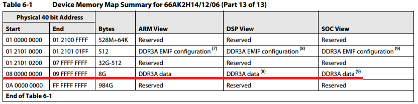

I had checked that it is possible to access the memory which excess 4GB range in CCSv6.02 memory browser (after loading xtcievmk2x.gel init file.),
For example, EVMK2H's DDR3A base address is 0x8000_0000 in case of "CPU Memory View"
If I change memory browser setting to "Physical Memory view", memory browser pointed to 0x8_0000_0000 automatically.
It is operated in the CCSv6.02, but it is not operated in above version as follows.
I need to 40-bit memory browsing using CCSv6.1, I don't think to come back previous CCS version.
There is some extra setting on the CCSv6.1 to enable 40-bit memory browsing?
