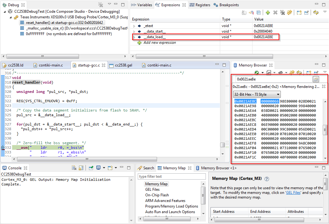

During a debug session with CCSv6 on my project, my initialized global variables doesn't get initialized at startup because the flashing tool of CCSv6 seems to not load those data in flash. I'm using as usual the following code to populate those variables at startup:
  pul_src = &_etext;
  for(pul_dst = &_data; pul_dst < &_edata;) {
    *pul_dst++ = *pul_src++;
The memory content at _etext is filled with 0 and thus my global variables get initialized with 0.

CCSv6 appear to be unconcerned about what is coming after the .text section during a debug session and won't load this part in flash.
Note that everything works fine and I'm able to run my program when I'm flashing the device with the Flash Programmer 2 software. After that, if a run a debug session by loading only the symbols, the content after the .text section are not zero and my global variables get initialized properly.
Thanks a lot for your help if there is a solution to this problem.

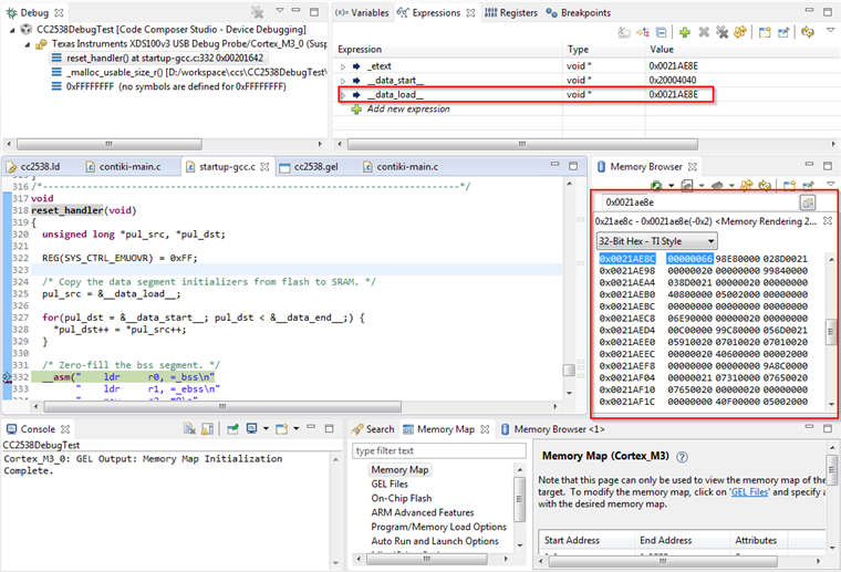

  • dark0 said:
    I tried then to use __data_load__ instead of _etext but still nothing.
    I now see that the linker script isn't the default one in CCS, in that it has two initialized data sections:
        .data :
            _data_lma = LOADADDR(.data);
            _data = .;
            *(EXCLUDE_FILE(*usb*.o) .data*)
            _edata = .;
        } > SRAM AT > FLASH
        .nrdata :
            _nrdata_lma = LOADADDR(.nrdata);
            _nrdata = .;
            *(.nrdata*)
            *usb*.o(.data)
            _enrdata = .;
        } > NRSRAM AT > FLASH
    Therefore, you would need two loops to copy the initial data values from flash to ram / nrsram, with the source and destination symbols matching those in the linker script:
    pul_src = &_data_lma;
    pul_src = &_nrdata_lma;
    for(pul_dst = &_nrdata; pul_dst < &_enrdata;) {
    [I don't have a CC2538 to be able to test these changes]

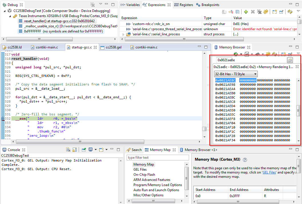

  • Yes of course but I don't initialize this second data section at startup. I do it latter in the code with a function this isn't a problem. To see the changes I'm directly watching the memory with the Memory Browser. Here the issue by images:
    Program loaded by the debugger:
    Program loaded with external flasher and then debug by loading only symbols:
    (edit)
    Further note: Now that there is a flashing verbose output option in v6.1.0 I can notice that the data are effectively loaded, but then why would this area be filled with 0? When I flash the device with an external tool I use the arm-none-eabi-objcopy.exe program to create a binary file from the .out file. This latter contains with no doubt the the initialized data because the program works in that case.
    OK, I now see that the flash hasn't been programmed correctly by the CCS debugger.
    To investigate can you:
    1) Under CCS Project Properties -> Debug -> Flash Settings tick "Enable Verbose Output".
    2) Enable CCS Debug Server Logging as defined here
    3) Download the program using the CCS debugger and post the CCS Console output and Debug Server log file.
    Could you also post the complete project, or failing that the linker .map file to determine what sections should be written to flash?
  • I just edited my previous post for the verbose output :)

  • dark0 said:
    The debug server log:
    (Please visit the site to view this file)
    The debug server log doesn't appear to show any flash erase or program operations. Was the debug server logging enabled before starting the CCS debug session?
    If not, can you try to enable debug server logging and then start a CCS debug session, and then post the debug server log again.
    dark0 said:
    Note that when I'm doing "Verify Program" in Run->Load->Verify Program... I got an error:
    Cortex_M3_0: File Loader: Verification failed: Values at address 0x000000000021AE8C do not match Please verify target memory and memory map.
    dark0 said:
    Cortex_M3_0: Writing Flash @ Address 0x00217fd0 of Length 0x00002ebe
     Cortex_M3_0: Writing Flash @ Address 0x0021ae8e of Length 0x000004f0
    The address 0x21ae8c at which the verification error occurs seems to occur at the boundary of two sections which aren't word aligned. Not sure if this is significant.
  • I enabled the debug log before launching the debug. Note that this time I enabled the "Full Verification" in the debug configuration and the program won't load completely and stop here:
    Cortex_M3_0: GEL Output: Memory Map Initialization Complete.
    Cortex_M3_0: Writing Flash @ Address 0x00200000 of Length 0x00007ff0
    Cortex_M3_0: Writing Flash @ Address 0x00207ff0 of Length 0x00007ff0
    Cortex_M3_0: Writing Flash @ Address 0x0020ffe0 of Length 0x00007ff0
    Cortex_M3_0: Writing Flash @ Address 0x0021ae8e of Length 0x00000530
    Cortex_M3_0: File Loader: Verification failed: Values at address 0x000000000021AE92 do not match Please verify target memory and memory map.
    Cortex_M3_0: GEL: File: D:\workspace\ccs\CC2538DebugTest\Debug\CC2538DebugTest.out: a data verification error occurred, file load failed.
    Here is the debug log:
    debugserverlog.txt
    I found in this file that the data section seems to be loaded but without error here (I don't understand everything in this file thought):
    0x00005294 22279 4  OFS D: OFS LOAD Section added:  name: .data
    0x00005294 22279 4  OFS D:   size in bytes: 1328, or 0x530
    0x00005294 22279 4  OFS D:   load location: 0x21ae8e
    0x00005294 22279 4  OFS D:   run location: 0x20004000
    0x00005294 22279 4  OFS D:   memory page: 0
    0x00005294 22279 4  OFS D:   offset in file: 147456 or 0x24000
    That part of the log file is reporting the size and location of the .data section, rather than actually loading the section.
    The point at which the initialized contents of the .data section is written to flash is the following in the debug log:
    0x00002DD8 33625 3 Cortex_M3_0 FLASH C: IFlashDevice::WriteDataToFlash( 4195F170, 0x000000000021AE8E, 1328, 0 )
    0x00002DD8 34044 3 Cortex_M3_0 FLASH R: IFlashDevice::WriteDataToFlash( 4195F170, 0x000000000021AE8E, 1328, 0 ) = (null)
    No apparent errors are reported during the flash to write. However, following a readback of the flash a verification error is reported (where the readback is aligned to a 32-bit word boundary):
    0x00005294 34047 3 Cortex_M3_0 GTI C: GTI_READMEM_WITH_STAT( 0x41B65ED0, 0x0021AE8C, 0x00000000, 0x00000534, 0x00000001, "R", 0x00000000, 0x00000000, *0x40960238 = 0x00000000, 0xFFFFFFFF, *0x00000000 = (nullptr) )
    0x00005294 34093 3 Cortex_M3_0 GTI R: GTI_READMEM_WITH_STAT( 0x41B65ED0, 0x0021AE8C, 0x00000000, 0x00000534, 0x00000001, "R", 0x00000000, 0x00000000, *0x40960238 = 0x00000000, 0xFFFFFFFF, *0x00000000 = (nullptr) ) = 0x00000000
    0x00005294 34096 3  XPCOM C: ( (dsIStringEventCallback*)3DEB0B60 )->onEvent( Cortex_M3_0: File Loader: Verification failed: Values at address 0x000000000021AE92 do not match Please verify target memory and memory map.
    Based upon the information in the log file, I can't tell what caused the programming failure. Hopefully a TI employee will be able to investigate further.
  • Your previous message put me on the right track and I finally managed to resolve the issue.
    I aligned the end of the .text section to 4-bytes boundary:
    I changed my linker script from:
    .text :
        _text = .;
        KEEP(*(.vectors))
        *(.text*)
        *(.rodata*)
        _etext = .;
    } > FLASH= 0
    to:
    .text :
        _text = .;
        KEEP(*(.vectors))
        *(.text*)
        *(.rodata*)
        . = ALIGN(4);
        _etext = .;
    } > FLASH= 0
    I don't know why this caused error during the debug session but it works now and I learned a lot.
