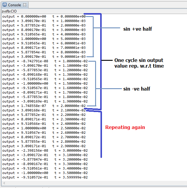

Hello Every one,
I am writing a sin() function code for plotting a sin wave in Graph window
Can you tall me, what i set in the option of Graph Properties (or any other setting), so that sin() function graph will be visible in the graph window.
I am writing error less code and "printf" print all the value of equation "output" perfectly.
#include<stdio.h>
#include<math.h>
#define PI 3.1415926
float t,output;
void main()
int f=50;
for (t=0; t<600; t+=0.001 )
output = 300*(1+sin(2* PI* f* t));
printf( "output = %e t = %e\n", output, t );
Hint:- Above equation "output" generate a sinusoidal waveform.

  • I am not cleared.
    In the above code when we run the output value printed w.r.t time(t) and those value represent like a sin wave value, but the Single time Graph not read that values.
    Inserting screen-shoot of that value, which in tabular form w.r.t time.

  • Ok desouza,
    still i'm not clear about the plot in Single time graph window for sin wave.
