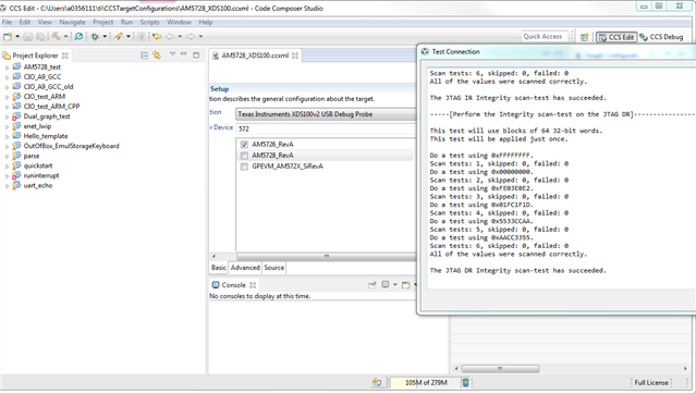

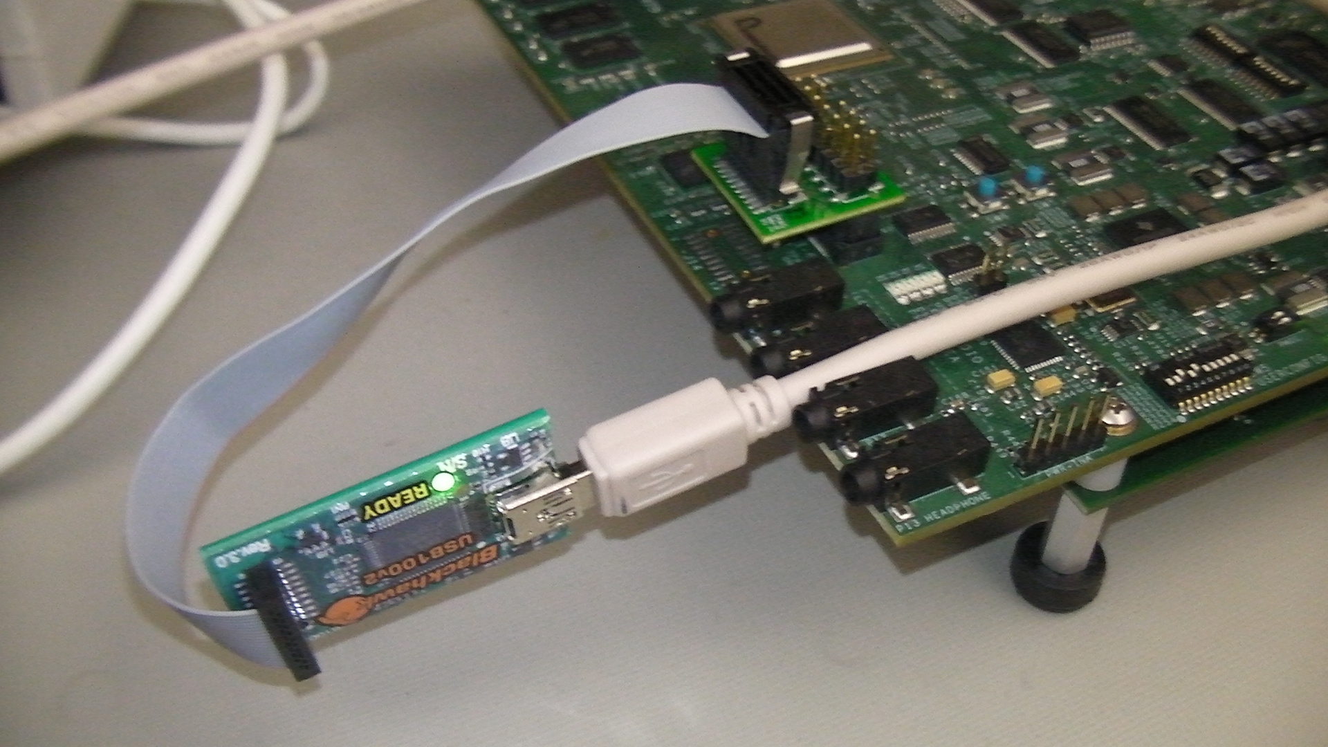

    The errors you mentioned are indeed strange; I wonder if something bad happened during the CCS installation. I am able to connect to my board here:
    How are you connecting to the board? The XC5777X board does not have built-in XDS100 JTAG circuitry, requiring you to have an external JTAG debugger and an adapter.

  • Rafael,  My connections look just like your photo.   I do see that we have different switch settings on the SW5 USERCONFIG.  I have only 4 & 5 on where you have 3 & 5 on.  I have no reference for the switch meanings, but I tried your setting and it didn't make a difference.
    I am going to try this on a Beagle board I have and make sure it still works there. That is what I got the XDS100 with a couple of years back.

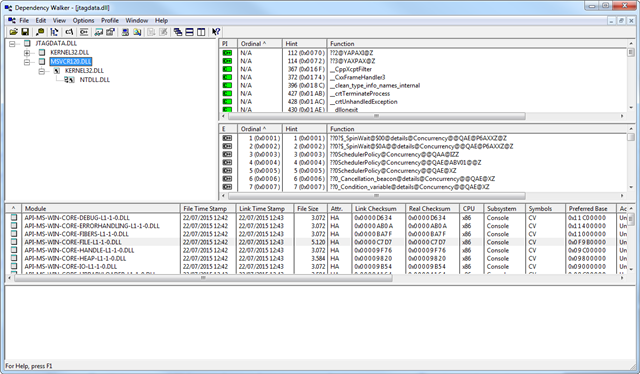

    The utility Dependency Walker scans through the dependencies of a given file and shows if there is anything missing. Can you download it from its official website and run it on the jtagdata.dll file? If everything is correct, you should see something similar to this:
    My suspicion is the highlighted DLL above (MSVCR120.DLL) is missing from your system.
    If that is confirmed, you may have to install the Visual C++ 2013 Runtime package separately.

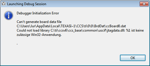

  • I also have the problem with CCS 6.1.1 on WIN7 an nothing I found in this forum or on google helped.
    Just a stupid idea:
    Just saw this 8.3 filename format in the path to the boarddata.
    Could this be an issue?

    I also found it remarkable that the error messge had 8.3 filename format in the path to the boarddata.
    ..\AppData\Local\TEXASI~1\CCS\ti\0\0\BrdDat\ccBoard0.dat
    and I posted the question if this could be an issue but there was no answer.

  • With CCS 6.2 an additional Info is displayed:
    "%1 is no valid Win32-Application"
    Whatever %1 should meant to be :)

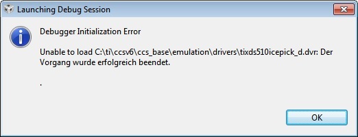

  • Regarding msvcrt120.dll I found some differences betweeen a functioning and a nonfunctioning PC when searching for the file in the windows directory.
    On the nonfunctioning system it could be found only once on the funtioning twice (system32 and syswow64).
    Unfortunately I was a little to eager and uninstalled all visual c++ redistributable packages.
    Anyhow the kind of error changed when I reinstalled visual c++ 2013 redistributables and I was at least able to do a succesful "test connection" from the target configuration page. I'm still not able to establish a real Debugging session though.
    Now the error message is like: "Unable to load .....\tixds510icepick_d.dvr: %1 ... no valid win32 app".
    Strange: If enabling Debug Server Log from Help->Support it looks like this
    The addional info changes to "The transaction completed successfully" (translated).
    Maybe reinstalling only the Visual c++ 2013 redistributables (which contain msvcr120.dll) could help for this problem.
