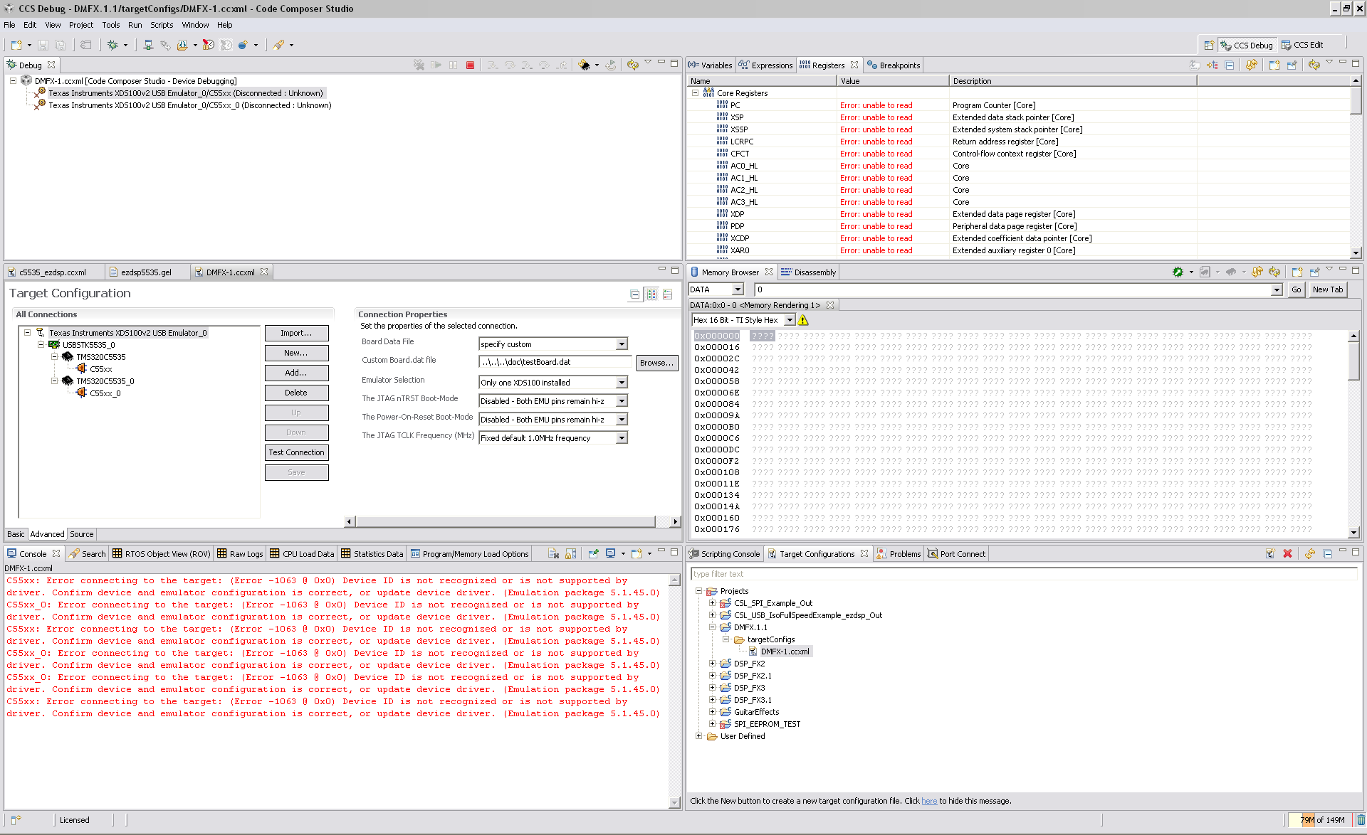

I have an issue trying to connect XDS100v2 emulator to a custom board with two C5535 DSPs.
I used same schematics as ezDSP5535 with both DSPs in JTAG daisy chain, except that EMU<0,1> are connected in parallel to both DSPs with pull-up and then connected to ADBUS6, ACBUS4 respectively on FTDI device. FTDI EEPROM device has been configured using MProg.
I use CCS V5.3.0.00090.
DBGJTAG test connection passes OK (see output below)
When I try to connect to any of the two targets I get the following error:
C55xx: Error connecting to the target: (Error -1063 @ 0x0) Device ID is not recognized or is not supported by driver. Confirm device and emulator configuration is correct, or update device driver. (Emulation package 5.1.45.0)
Result is the same using the ezDSP5535 GEL file or without GEL file.

There is something weird on the dbgjtag results:
The test for the JTAG IR instruction path-length succeeded.
The JTAG IR instruction path-length is 12 bits.
The test for the JTAG DR bypass path-length succeeded.
The JTAG DR bypass path-length is 2 bits.
But actually JTAG IR instruction path-length should be 38-bits and not 12-bits.

I would like to know if there is any info regarding DSP Emulator commands. I tested the Boundary Scan and it works perfectly, so I would like to be able to send in a DSP Emulator command into the JTAG chain and analyze the response for any clues on what's going on.
Issue solved!!
EMU0 and EMU1 must NOT be connected to the FTDI device unless there is a CPLD that provides EMU_EN to those pins.
By probing with a scope I observed that EMU0/1 pins were actually changing from 0 to 1 several times while running DBGTAG or launching emulator, even if they are configured as disabled and hiz.
I first disconnected EMU0 only, since is the pin that is sampled at TRST_N to decide to set the C55 devices on Boundary Scan or Emulator mode, but it did not work either.
I then disconnected EMU1, and DBGJTAG returned correct IR adn DR size registers (see DBGJTAG output below).
I then run CCS emulator and I was able to connect to the targets.
