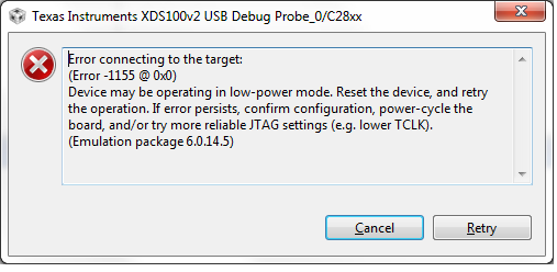

Error connecting to the target: (Error -1155 @ 0x0)
Genius 5910 points
I had a problem uploading Flash to my F28069M. After that I got the error: (Error -1155 @ 0x0)
 Is there any other way to solve this then by a solder Iron?
    Can you use the test connection utility to test your JTAG connection? please post the full results here.

    I worked with it for weeks before I got an upload error. After that I got this error and it didn't work anymore.
  • This means that the JTAG connectivity is all fine. Check the health of your controller. I feel either your controller is locked or damaged.
    What error message does CCS display after (Error -1155 @ 0x0) ??
    Gautam
  • This is the complete error message.  This first happens after I got a flash upload error message.
    Can you check the "low power run mode" section of the page below? That may give you a few additional hints.

  • Thanks.
    I replaced it with an other one. That solved it. To bad it is so easy to brick them.
  • Great! Be careful now :)
    Goodluck & Regards,
    Gautam
  • It happened again. And ,I  think I, know why. The power supply of my Jtag is not powerful enough. So when the main power supply is not powered. it bricked my controller. I think it is a real pity it is not possible to recover a corrupt image flash.
     To the solder Iron, again.
