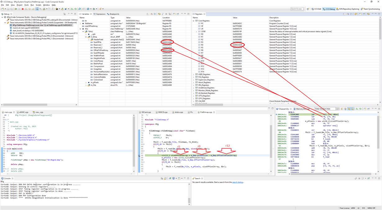

Access to member variables in a "__attribute__((packed))" struct ?
Hi All,
I try to load a .BMP file from an SD card on the Beaglebone Black (using CCS 6.1, no OS, bare metal and some StarterWare).  I defined the BMP structure as follows:

When I try to load the BMP structure from a file, I get errors (jump to error handler) whil trying to access m_Bmp.SizeOfFile :
FileBitmap::FileBitmap(const char* fileName)
		FRESULT 	fRslt;
		uint32_t	br;
		fRslt = f_open(&m_File, fileName, FA_READ);
		if(FR_OK == fRslt)
			fRslt = f_read(&m_File, &m_Bmp, sizeof(BMP), &br);
			if(FR_OK == fRslt)
				uint32_t sizeOfPixelArray = m_Bmp.SizeOfFile - m_Bmp.OffsetToPixelArray;
				m_pPixels = new uint8_t[sizeOfPixelArray];
				fRslt = f_lseek(&m_File, m_Bmp.OffsetToPixelArray);
				if(FR_OK == fRslt)
					fRslt = f_read(&m_File, m_pPixels, sizeOfPixelArray, &br);
I think this has something to do with alignment, but don't know how to solve this.  I can't change the layout of struct BMP...
Any suggestions are welcome !
Thanks, Paul
  • Do you use the TI ARM compiler?  For right now, I presume you do.  Please preprocess the source file which contains the function FileBitmap and attach that to your next post.  Also show the compiler version and build options.
    Thanks and regards,
    -George
  • Hi George,
    I'm using ti-cgt-arm_5.2.5 compiler.
    This is the output of the preprosessor for the file:
    (How can I attach a file instead of including it in the post? )
    Thanks.
    		FRESULT 	fRslt;
    		uint32_t	br;
    		fRslt = f_open(&m_File, fileName, 0x01);
    		if(FR_OK == fRslt)
    			if(FR_OK == fRslt)
    				if(FR_OK == fRslt)
    	FileBitmap::~FileBitmap()
    		delete [] m_pPixels;
    } /* namespace BPg */
  • What are your exact build options? It is easiest to see this in the build console window.
  • BeagleBone Black has a Cortex-A8 CPU, which should be able to handle misaligned accesses just fine. You say you get a "jump to error handler." Exactly what does that mean? Are you getting some sort of unaligned memory access interrupt or exception?
  • This is the output on the Build Console :

    I inserted a breakpoint at line 88 in file FileBitmap.cpp.  The debugger hit this breakpoint (see pic).  After assembly-stepping ONE step, the program jumps to
    4030fc10:   E59FF014            ldr        pc, [pc, #0x14]
    AFAIK, this is somewhere in the L3 OCMC0 (bootloader from the JTag or .gel ??)

  • Hello Stephen,
    AFAICS, at the moment sizeOfPixelArray is calculated, R4 (0x8002A848) is the this-pointer (pointing to the FileBitmap instance).  4 bytes are reserved for the v-table pointer, so that the BMP structure starts @ 0x8002A84C.  The value of OffsetToPixelArray is @ offset 0xE from the this-pointer, so that the asm-instruction
    ldr   r12, [r4, #0xe]
    loads the value into R12.
    But singlestepping in the Disassembly (Control + Shift + F5) imediatly puts the cpu in abort mode (CPSR mode 17)
    I'm quite confident that it's a misaligned acces, but I don't have the experience to solve this problem atm.
    Thanks for your time !
    Paul.

  • Chester Gillon said:
    Your debugger screen shots that that the CCS status is reporting that the MMU is off.
    For my own edification, how were you able to tell that from the screenshot?
    From the bottom right of the CCS window, which displays the target status:
    The MMU is Off after a system reset, until enabled by the software.
