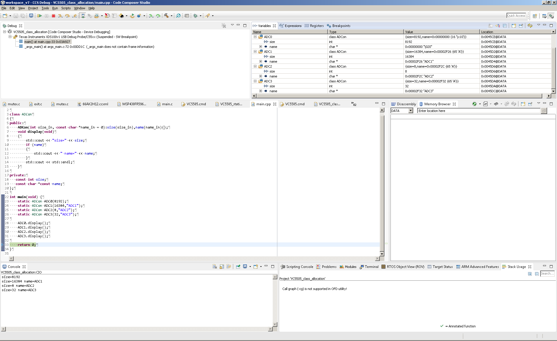

    Can you post an example project which demonstrates the problem?
    I think you are encountering a different problem, since I ported my examples for the MSP430 v4.2.3 and ARM v5.1.5 compilers to the C5500 v4.4.1 compiler and haven't been able to re-create the problem.
    Attached are the example projects for a TMS320VC5505 device VC5505_static_variables.zip
    VC5505_class_allocation.zip
    The CCS 7.0.0.00042 debugger showing the correct values for local static variables in the VC5505_static_variables and VC5505_class_allocation example projects:
