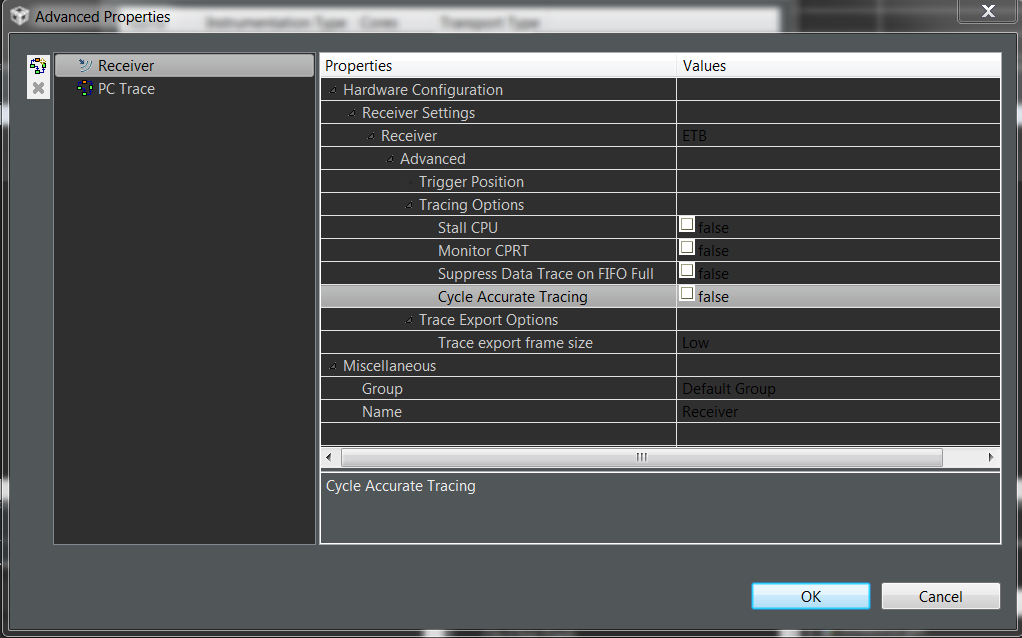

    It is pretty clear that the issue here is bandwidth.  Apart from using a different trace export clock, I don't think there will be a way to remove all gaps for cycle accurate trace for your device.  Another option might be to disable cycle accurate trace in the receiver settings shown below.  This will make all timing information useless but should give enough bandwidth to get a sequence of PC data without any gaps. Hope this helps.
    Mark
