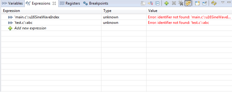

    The assembly code for project I posted is shown below.  As you can see u16SineWaveIndex is located at address 0xC009 and abc is located at 0xC00A.
    While debugging the source code, the Expression window shows the following:

  • I have looked into your project.
    The debug info for u16SineWaveIndex does not indicate which source file the variable was declared.
    That is why we do not associate it with main.c.
    In my opinion, this is a compiler issue.
    I will report to the compiler team.
    Raymond

  • Hi Stephen,
    I took a look at your project and the issue appears to be that link time optimization (aka whole program optimization) is being used in the debug build.  (--opt_level=4).  What's happening is that during this optimization, the files are being mixed together in such a way that the debug information is no longer clearly delineated between files.  (Which is representative of what happens during link time optimization to the code itself.)
    As a general rule, the higher the optimization level, the higher the degradation of debug information, and this is an example of that.  If you lower the optimization, you should be able to view the static variables.
    Zachary Morgan

  • > I would think the compiler tool set could figure out which variables are associated with which file and save that information for later use.
    The problem is a little more involved. The way link time optimization works is by taking the input translation units and concatenating them into a single translation unit so that the toolchain has greater context to optimize with.
    With DWARF debug information, CCS's answer to "which static foo is this?" is answered by the containing DWARF compilation unit (which is approximately equivalent to the idea of a translation unit in source code.) A compilation unit can only claim to be from a single file so it claims to be from no individual file, if that makes sense.
    Further, due to multiple possible static foo's, they become foo$1, foo$2, etc inside of that compilation/translation unit. That is, due to being put into a single translation unit, the original static variables have been replaced with uniquely named ones.
    That being said, it may be possible to break up the monolithic link time optimized DWARF compilation unit into multiple compilation units to be more representative of the original source -- I will track this issue as such.
