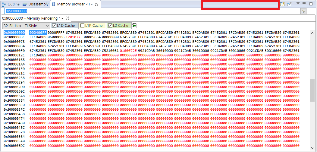

I use a CCS v6.1 and I connected to DSP in Keystone2 EVM board .
I want to check DDR3 memory continously. but I can't fine refresh icon.
Memory brower has no icon.
What can I do?
Regards.
Shin.
You may be encountering the problem where the CCS 6.1.1 Memory Browser can open without all toolbar options. The work-around is when in the debug session, to close and then re-open the Memory Browser view.k.s shin said:I use a CCS v6.1 and I connected to DSP in Keystone2 EVM board .I want to check DDR3 memory continously. but I can't fine refresh icon.
The problem has been fixed in CCS 6.1.2
